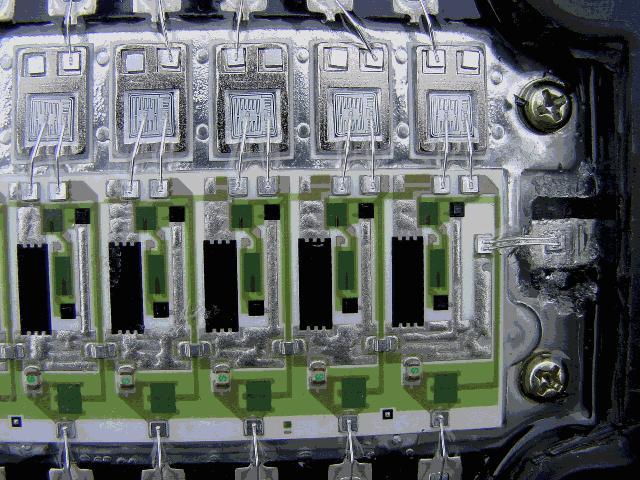

I really wouldn’t get to pent up about it. Think logically, it can sit in some alcove in the nose cone or directly behind a gurt big fan. How many Z32s are driving around after 25+ years with series 1 PTUs in the stock location.
The ptu failures is not from external heat but from internal heat caused by poor connections at the connectors, this increases the current draw through the unit and hence the internal silver solder melts.
Jeff
