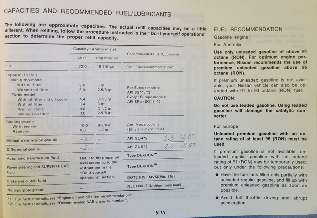

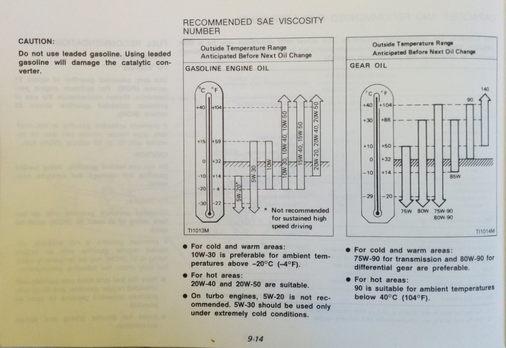

I was wondering what oil you guys use? It's been a while since a change, due to doing so few miles and its still pretty clear. I think my usual choice is either 0-30 or 5-30?

My only advice is to say that a "30" grade when hot is too thin for a twin turbo! Go for nothing less than a "40" grade - either a 5w40 synthetic or a 10w40 semi (which is what Nissan recommended). Stick with the usual good quality brands and you'll be just fine....

Thanks for the advice guys, much appreciated. Oh and I have no turbos , does that make a difference to lubricant needs?

Hi Matt,
The captions relate to the question that comes up time & time again!
Having owned a z for you say seven years? Are you now asking which oil:huh:
Some of the owner on here change their oil every six months regardless of miles done.
I know some maybe very excessive but oil is relatively cheap compared to a problem engine on the z.
I use 10/40 oil
Art
Ahhhh, things like that just go over my head sorry hahha. It does sound like a simple question, but I just couldn't remember what I'd used previously? The car runs superb, but as I'm doing about 2-300 miles per year, I thought from now on I'd change it once. Any major issues I had used to go to zedword .
Yep 10w/40 seems the way to go though, thanks Art.
