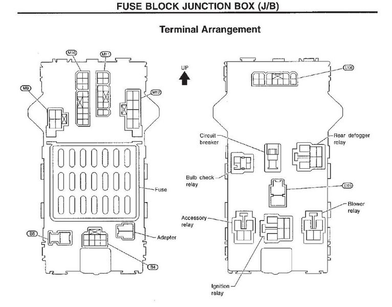

Hi all,
behind the drivers footwell fuse board are a number of relays as you know. Can I ask which one controls the wipers, clock, left pod and cig lighter.
Thank you in advance,
Steve
Accessory relay. It’s the blue one that’s nearest the driver when the fuse box is in place.

Does anyone know what each relay controls please...specifically the blue one next to the one I am replacing (horizontal too). Thank you
Finally, am I right in saying that the parts number for the defogger brown relay should be 25230 C9963. Not with the car and would like to order before getting back home if possible, hence the question.

On 22/05/2018 at 13:56, AndrewG said:
Power supply routing which indentifies relays and the circuits they control:
el-10-11-1.pdfUnavailable
and diagram of fuse block/junction box identifying relays:
Hi, came across this.  Not sure if anyone will reply.  I’ve a buzzing blown -bulb check relay as in above diagram.  What does it do,  and are there replacements etc available… cheers
