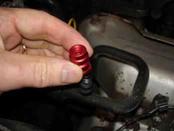

Before going down the route of changing the entire as system, get hold of some port converters off e-bay and fit them to the pipework ( easy ) go along to the ac man and say hey can you do a check for leaks using a cheap inert gas.
Once checked and vacced down ask them to add some pag oil to keep the compressor happy and add then a volume weight of R134a that is slightly less than the volume weight of R12 on the label at the front of the car.
Then when complete and all running with nice cool ac, be happy it cost you just £50 to £80 rather than hundreds to change the system, yes it is a compromise and maybe only 90% as good as a newer type system.
