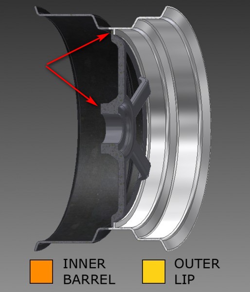

Yes, you will need the dimensions of the barrels as the centre of the wheel where wheel offset is measured from is not
necessarily the same as the offset of the spokes and barrels joint relative to it (as I have arrowed below). There is another
calculator I have found which works for split rims using barrel dimensions. I have not played around with it much but it
should help you get closer to what you need:
