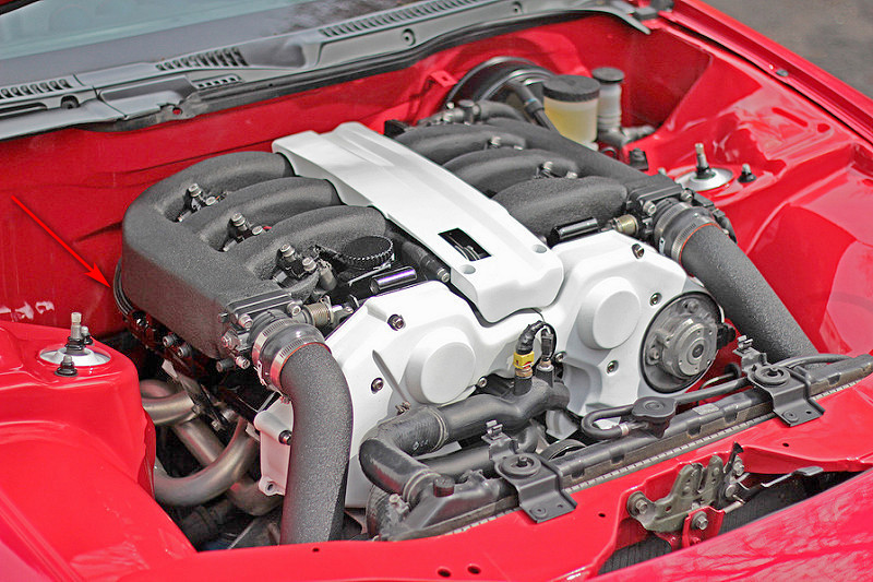

If it's anything like this well known plenum modified example then the balance bar has been replaced by a hose (arrowed)
and fittings running underneath the plenum from bank to bank.
