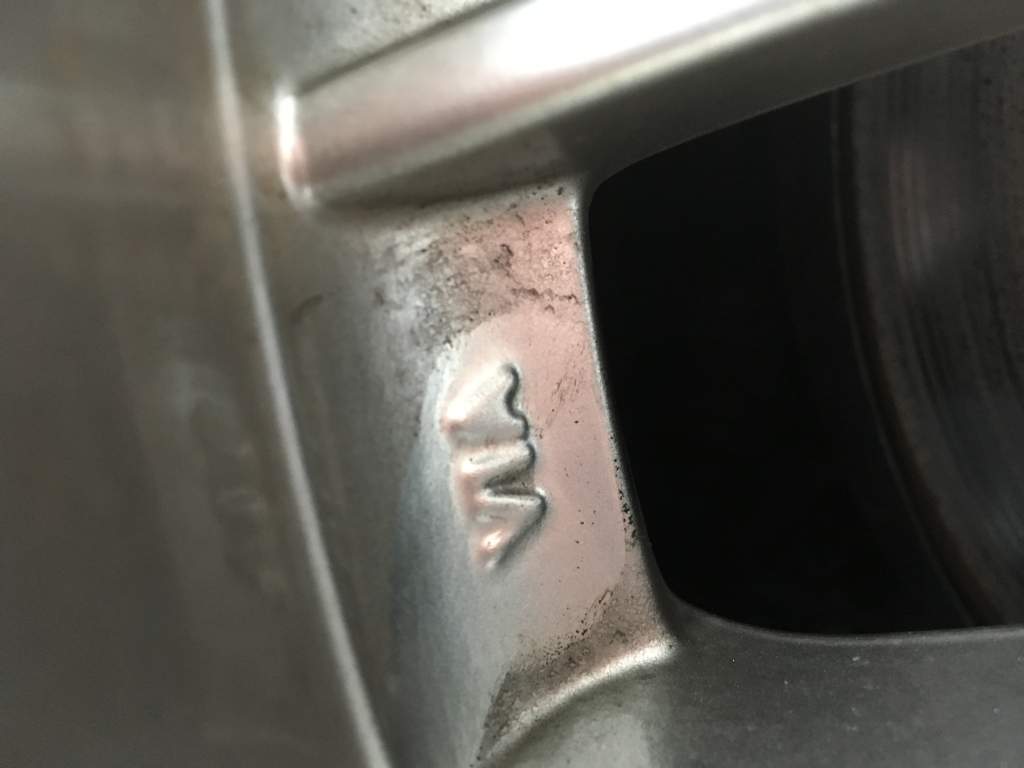

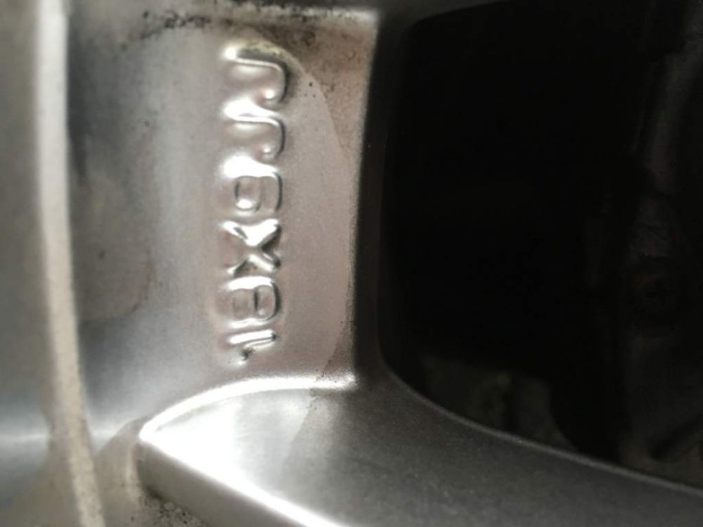

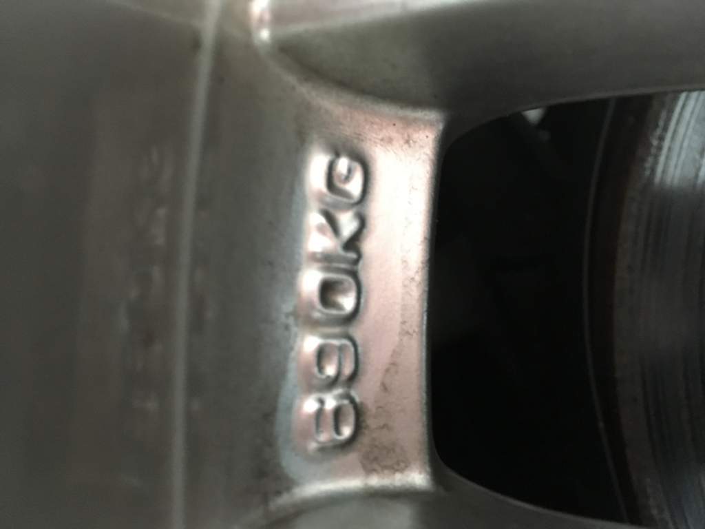

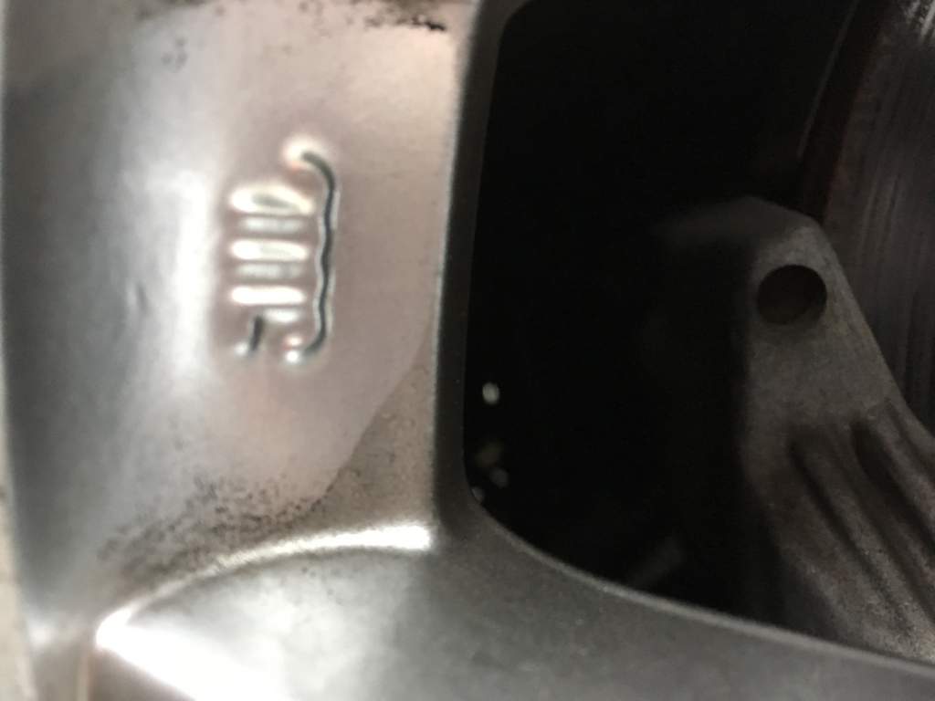

Well it turns out that once you know you're looking for something then it's easy to find. Not that anything makes much sense to me...
Rears,18x9 JJ, not sure what the second picture says (and I can find a similar marking on my UK and JDM original wheels), VIA (don't know what this means and 690KG.
The fronts have the same markings others the 18x8JJ.

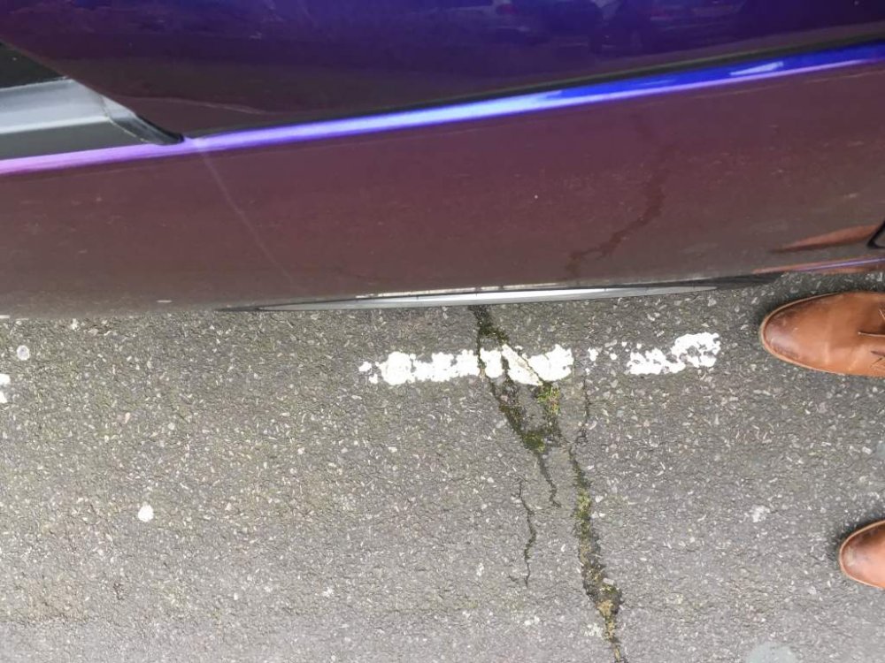

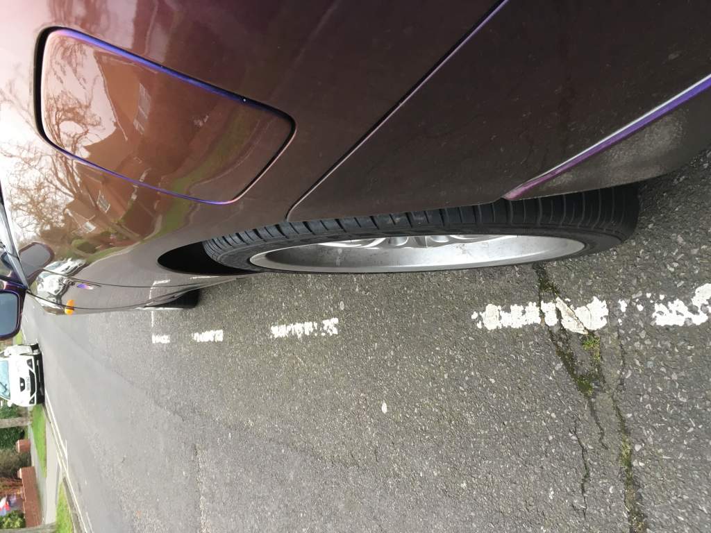

Here's some pics of the current tyres...
They certainly aren't stretched. They look about the right size for the rims.
Your wheels are 9j. If you want slightly larger tyres you can make them 1-2cm wider imo.
I've seen popper stretched tyres and i wasn't suggesting there was much in it but I thought there might have been a bit more rubber to get on the rear. I'll stick with a new set with 265s on the rear then. Thanks guys!
