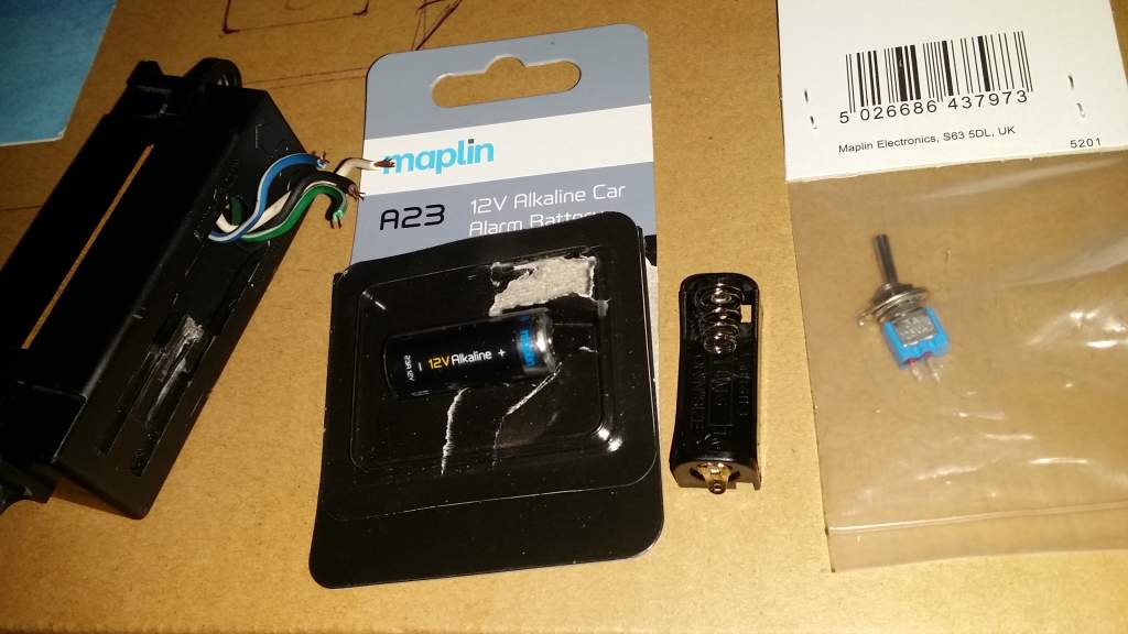

I'm trying to make a 300zx clock run on a battery. I was all confident but I cant make it work.
I thought the clock was a serviceable item. So I assume the battery has insufficient current???
I have been using crocodile clips and short lengths of wire to try and get it to do something but there are no signs of life at all.
Any ideas? And does anyone know which wires are which. I thought black was earth, blue was live and the others are to dim it.
[ATTACH=CONFIG]110189[/ATTACH]
Help please.

I think it's a milliamp shortage... When it didn't work I tried every combination of + and - wiring
A xar battery would be a bit heavy in the glass cabinet :lol:
Oh good point. So could I try something with a laptop charger or phone charger????
I'm going to go bang aren't I :lol:

So having tried every combination.
Either the clock is dead or the battery is providing the wrong flavour of electricity?
That clock does not work. I have had it clipped up to the zed battery every which way.
