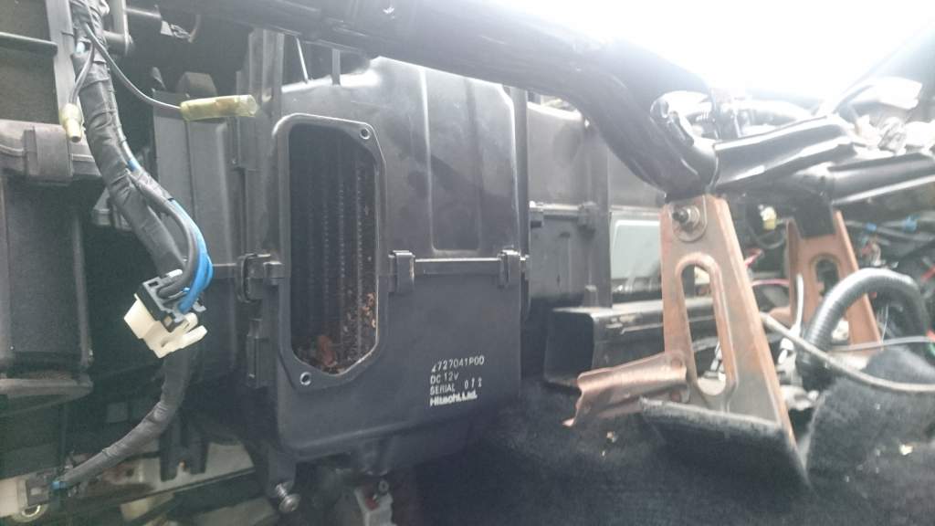

I've got the dash off, cluster off, wires taped and labelled, duct work off, stored, sensors in the right places, bolts back in holes so they don't get lost.... but I can't get the *expletive* heater box anywhere near off. Shiny new P10 Primera heater matrix is sitting on top of my fridge waiting to go in but I'm more stuck than a stuck thing covered in glue in a tight space.
I've been following various writeups as best I can (most seem to have lapsed their image hosting) but they all seem to say 'remove this, remove that' with regards to whole units, with little explanation as to how or why, so I must once more dive into the pit of wisdom and knowledge contained within this fair forum.
The heater box itself is looseish, I've removed all I can see of the bolts although I'm pretty sure it's entrapped by this doofer containing what I assume to be the A/C rad, which isn't coming off despite all the visible bolts being free.
What exactly, and precisely, or a combination of the two, holds the AC box and the heater box in? Any little tips or tricks?

To remove the heater box I had to take the blower out, then the AC evap then the heater box. But I remember a post somewhere that said you can extract it from the other side?
Edited by Alic
Hate to tell you buddy but your picture is of the ac condensor not the heater matrix, the matrix is extracted on the drivers side, and if you guys will please please listen every time a matrix job is mentioned YOU DO NOT NEED TO REMOVE THE DASHBOARD, it slips out of the heater box on the drivers side where your left foot ( clutch or auto-box rest ) would be.
It really is a 30 minute job to remove, honestly, used to do these in customers dinner hour whilst they waited, the Aus site shows in detail how to do it without removing the dash !

And I too hate to say it, after you have gone through all that effort, but that is why Jimmer did mine all-in; parts labour and new coolant etc. for just £245!!!
I decided on the dash out method mostly because I don't have spares of the copper pipes that the dash in method recommends chopping, and I needed the ducting apart anyway as it's all full of grotty coolant.
I'm also not nearly nimble enough (or small enough) to get in under the pedals with the seat in and not being able to fully open the drivers door. Spent ten minutes with my feet on the headrest trying to look for it and only succeeded in getting a headache!
No pipe chopping required, they just undo, and removing the seat is the key.
