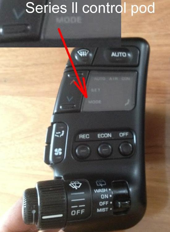

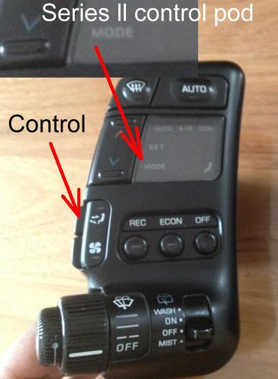

Later control pod in picture below has a mode setting.
