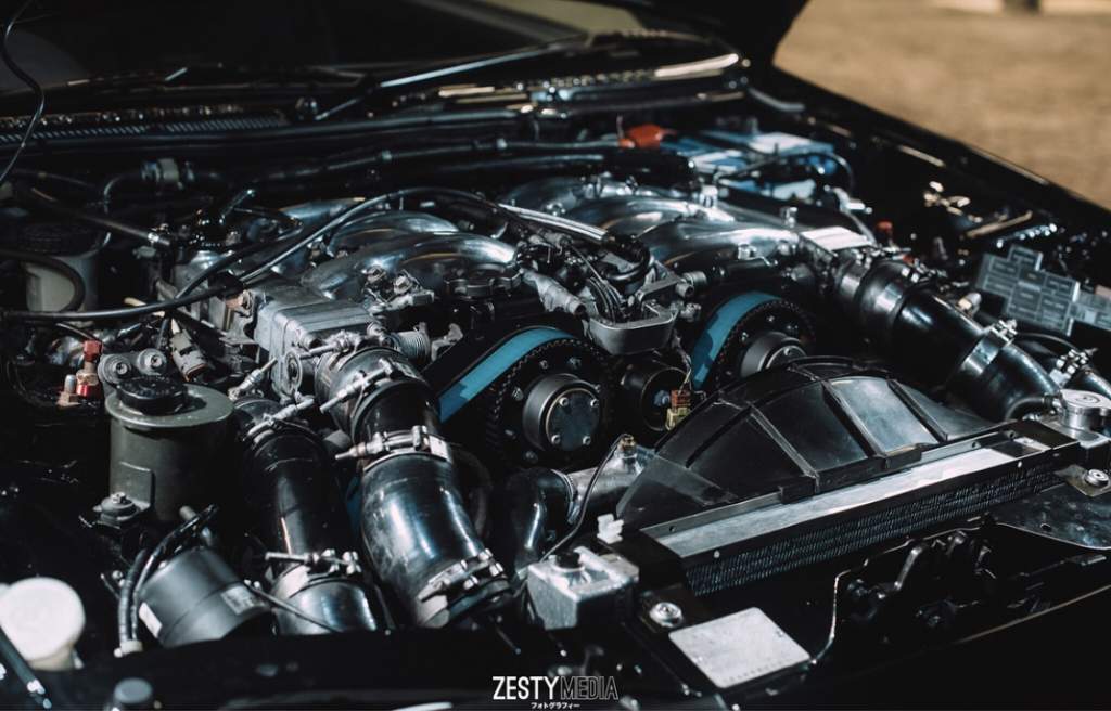

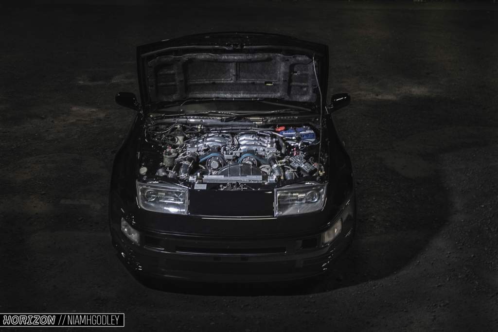

Anyway, before I discovered this little issue, a new “car media” company asked for my car for a photo shoot.... here are a few of this pics of my car
