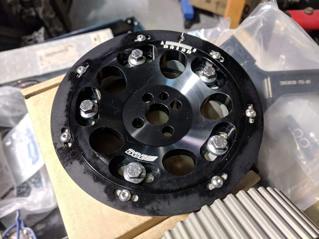

This means I get rid of the Nissan optical sensor in the CAS, and it allows my Haltech to know an accurate crank position with the timing ring on the Harmonic dampener and a Hall effect sensor. This means more accurate ignition timing, and a better state of tune.

This nicely demonstrates the timing wander you get with the CAS (and this is with an AEM 24-1 CAS wheel, which has less resolution that the OEM CAS disc). Both feeds are taken at circa 6200 rpm.
Pink line is CAS, Black is crank trigger wheel
[ATTACH=CONFIG]115965[/ATTACH]
Think this shows perfectly how much the ECU has to guess what the crank position actually is! With the AEM cas disc, there is s variance in timing of 7.3 DEGREES!! THATS HUGE!
The increased accuracy will result in a better ignition timing map and potentially gain a few degrees of ignition advance, and therefore more power and torque across the Rev range

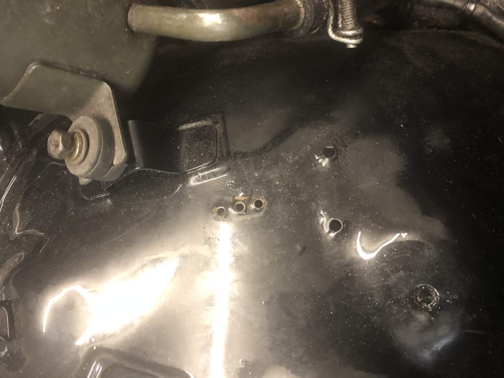

First I relocated the alarm siren out of sight by the drivers side SMIC. Had to redo the complete hash of a wiring job by the company who installed the system (I mean who wraps a single wire with black electrical tape!?!)
Annoyingly it means I’m left with 3 holes where the siren had been mounted under the bonnet.... will have a ponder with how to rectify this

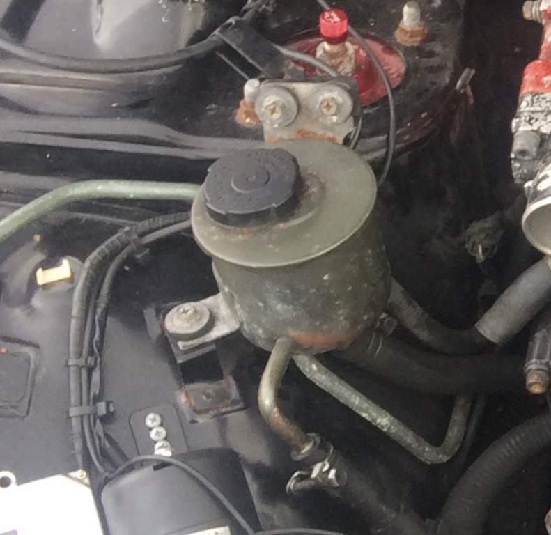

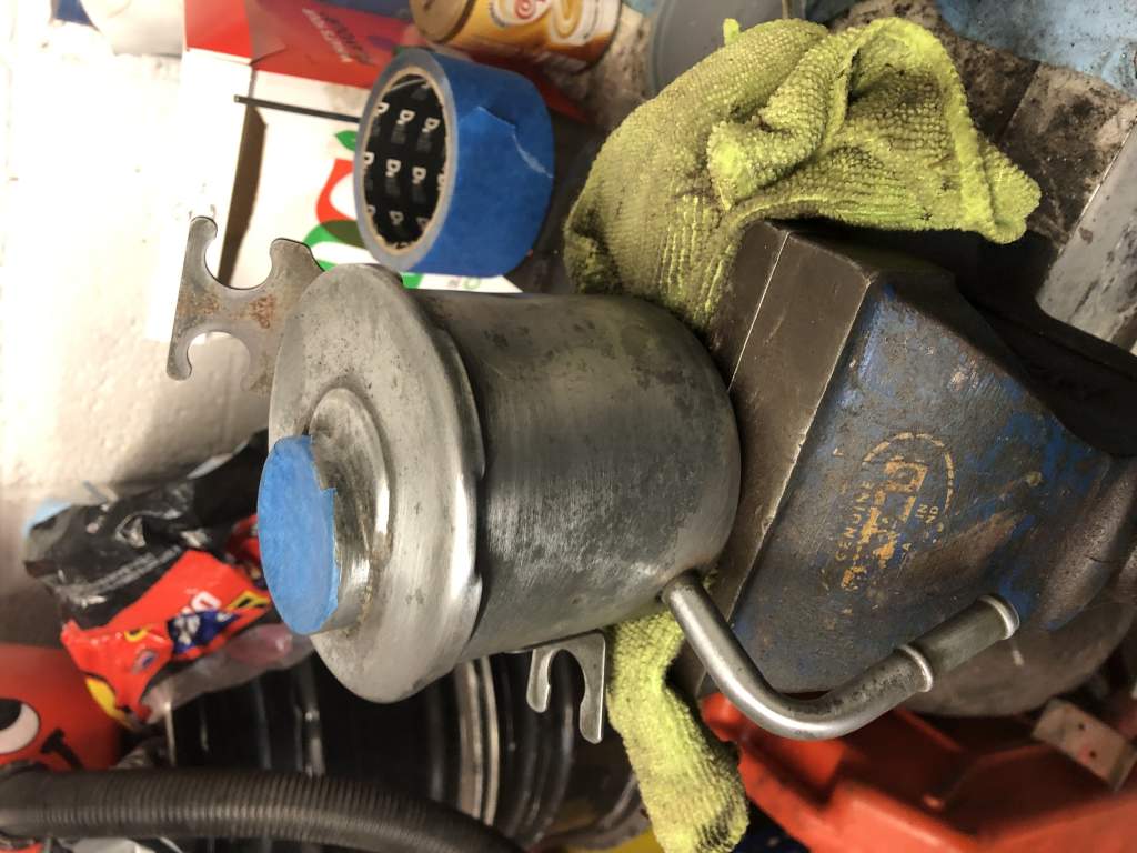

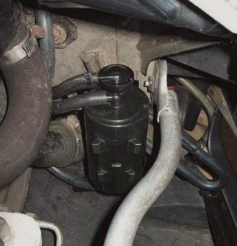

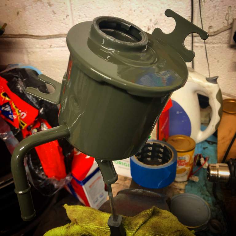

Also decided to start a quick refurb of my PS reservoir as it was showing corrosion through the paint. After rubbing the factory paint off, there was a fair bit of hidden corrosion and pitting that’ll need tackling

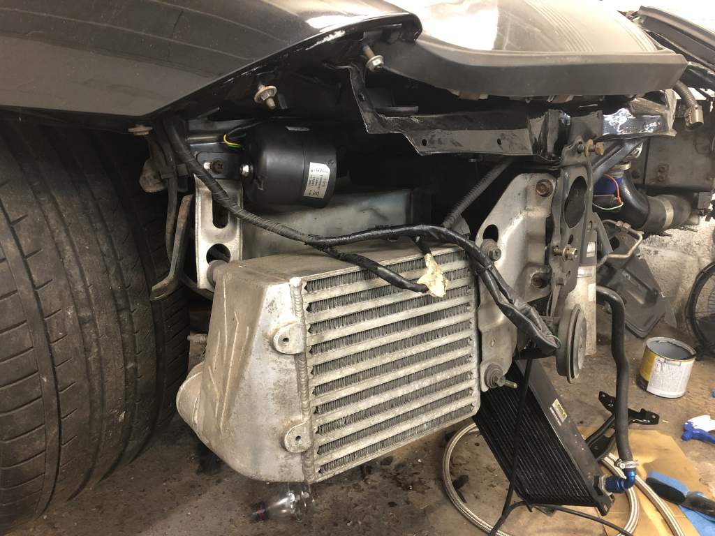

I’ve also been pondering where to mount my remote oil filter head. Due to the size of the EPR baffled sump, you cannot mount and oil filter on the OE filter tree. I’ve decided that I don’t want to go to a full flow oil cooler setup as I like having the safety of a bypass valve should the filter become unexpectedly blocked (bypass valve prevents oils stavation should this happen), so rather than using the BDE kit, I’ll use an adapter on the oil tree, -10 braided line with AN10 fittings, and a remote filter head.
One option is to put the filter head under the nose section, but it appears that routing such a large bore line past the rad and IC pipes may be problematic. Another option is down by the bulkhead by the steering column, but again, it’s difficult to know if I’ll have the space without the engine in the bay.

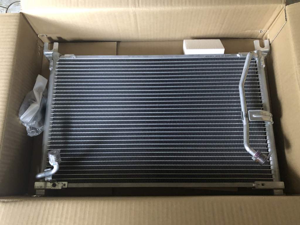

The FedEx fairy dropped by today and delivered my new AC condenser and clutch fork boot
I’ll probably wait unti the engine is back in before I fit the condenser. It should make life a little easier with the auxillary belts, and I still need to finalise where I’m going to mount the remote oil filter
The shopping list only has a couple more parts left on it, but I should be able to sort those out prior the delivery of the engine

While it’s an option, I’m trying to declutter the engine bay (which is why I relocated the alarm siren), so I think having the filter in the bay would just take up a space I’ve just cleared out
Fair enough. There is also a space opposite the A/C dryer which I used for the relocated CC which could accomodate
the remote oil filter. The oil feed and return lines would have to be routed past the radiator. What does EPR have to
say on the matter as it's their sump design making this issue?
That’s one potential space I’m considering. I just need to work out of it can get the -10 braided lines through a gap somewhere.
Normally people go do a “full flow” setup which would removes the OE oil cooler lines and the -10 lines would run in their place. I’m not going for a full flow setup from a variety of reasons, so it means I can’t gain the extra space by removing the Oe oil cooler lines
Edited by nickz32

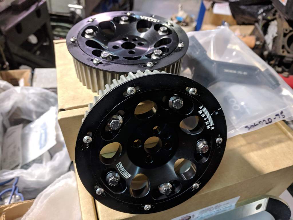

As I’ve just forked out for a set of Camshafts, that extra £200 will come in handy

Finished my PS pot resto today. It’s not quite a perfect match to the OR colour, but it’s really close.
It’s only a rattle can job, using Halfords “Matte Military Green” covered with a ProXL 2K clear coat. I’m pretty pleased with the result
A vast improvement on what it used to look like!
