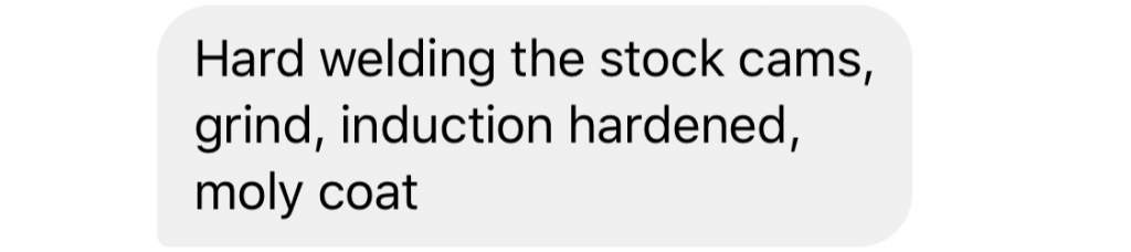

What cams were you hoping to use?
EPR Genesis 1 cams.... 272degree @ 10.2mm lift
Why do EPR want your core camshafts?
They do?
Edited by nickz32
I was going to guess they were regrinds, but that doesn’t make sense as regrinds usually have a reduced base circle, which the EPR one don’t (they retain the OE base circle)
Quite possible, and they’re then “fully hardened” with some form of hardening process?

You can reprofile a cam by removing material from the existing lobs but it can increase the stress levels and make
it more difficult for the followers to keep in contact with the profile especially at high revs. Starting with a blank or
building up the lobs can give a new profile with lower stress and easier to follow at high revs.
A local company to me that build engines, also specialise in porting and head work. I had a camshaft from an Uno Turbo(!) reprofiled by them about 20 years ago and the owner showed me the process. He was very knowledgeable and gave me a little tour of the operation. At the time he used to do all the camshaft profiling and head work for Piper Cams which was quite lucrative and when I ordered a Piper cam and given a local address for the core, I thought I’d check it out.
Seemingly the company is still going, I wonder if using a local company to do the work to your specification in the future would work out more cost effective?
It’s can certainly be a consideration...... although Piper cams were never regarded as top quality products
I thought that was just the norm, grinding the stock cam without adding meat and then just adjusting the clearances to suit is the bargain basement way!
Which is precisely what JWT do, just starting with fresh cores

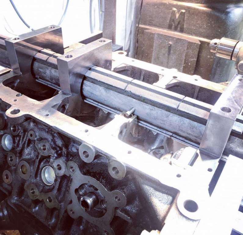

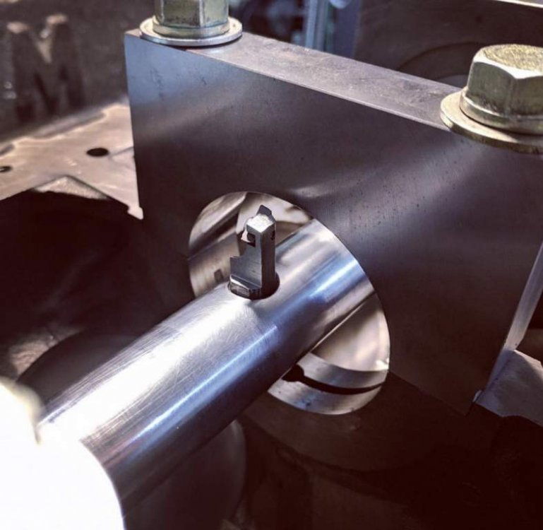

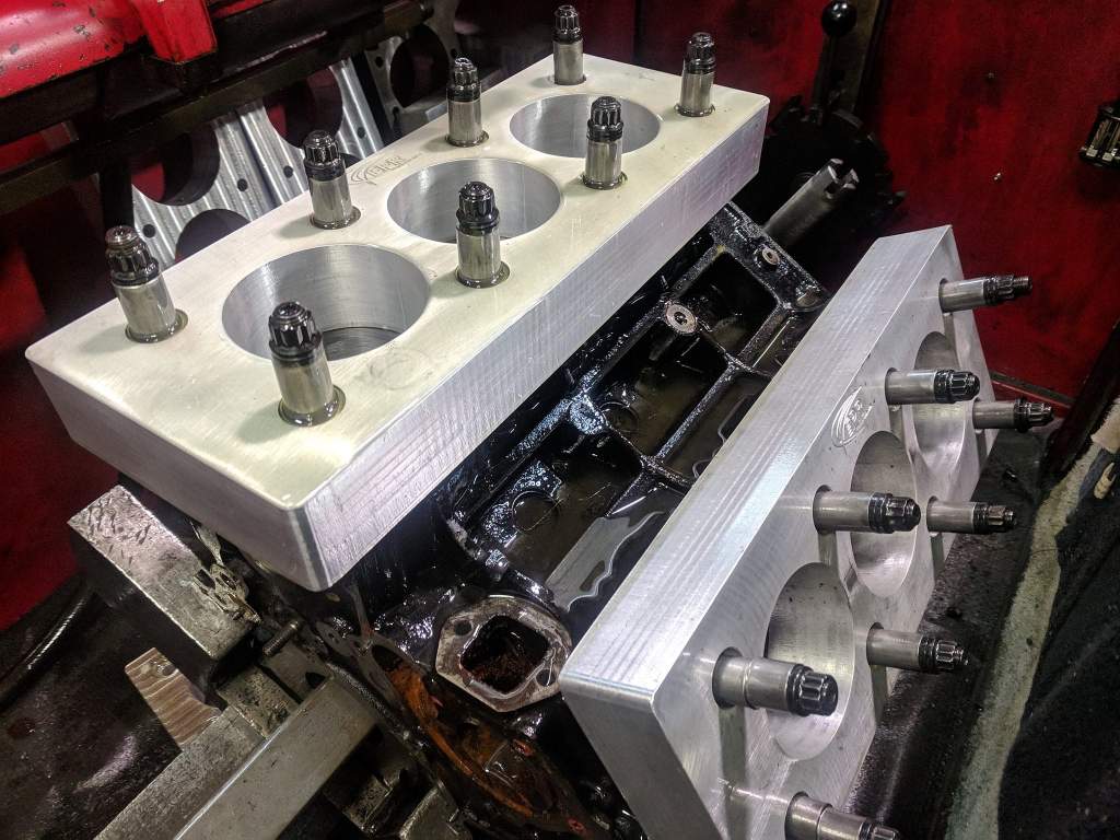

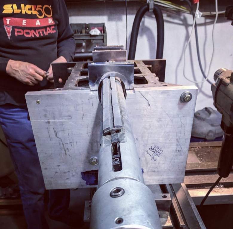

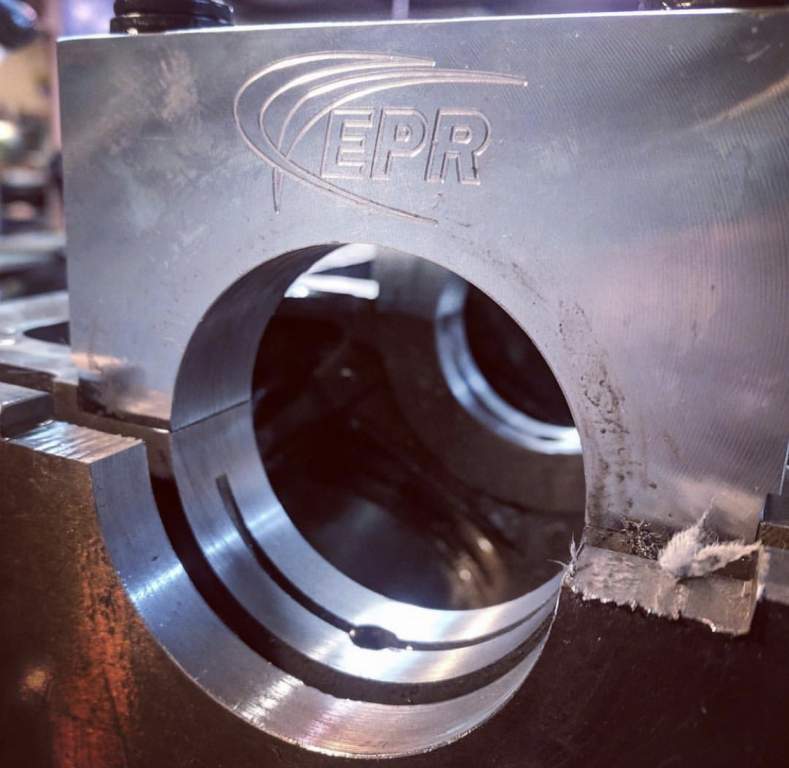

A little EPR update. Main caps have been bored and honed. Now it’s time for the cylinders to get the same treatment
