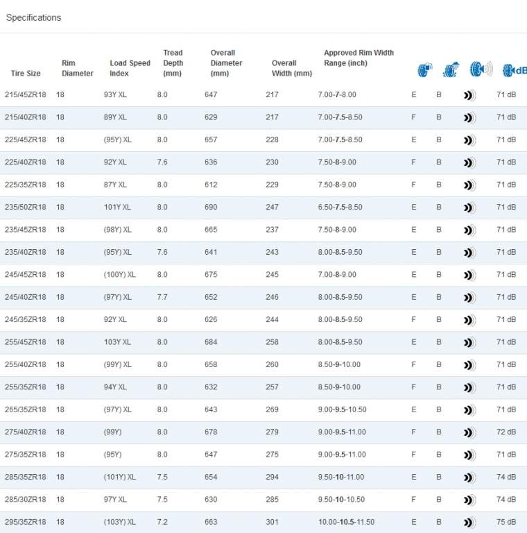

Would there be much difference if put 225/40 instead of 235/40 on the front and 255/35 instead of 265/35 on the rear. Would it affect the Speedo much because I can save £80 by going for 10mm narrower tyres
This is the specification table for Toyo T1-S tyres (other manufactures have similar tables). You can compare the overall diameters for the
tyres sizes above and work out the % differences.

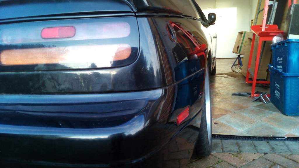

This one is by far the worst

An alignment wouldnt solve the whole problem. This is the camber gained by lowering to the point that the tyres are level with the arch:
Its not too bad but will cause uneven wear.
