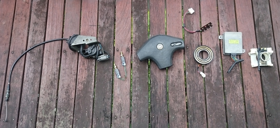

Parts required (not including loom parts):
[ATTACH=CONFIG]109679[/ATTACH]
Thanks for the response guys, so sounds like just don't bother, its a good bit of work if you have the time more trouble than its worth, and loads more parts to look for.
