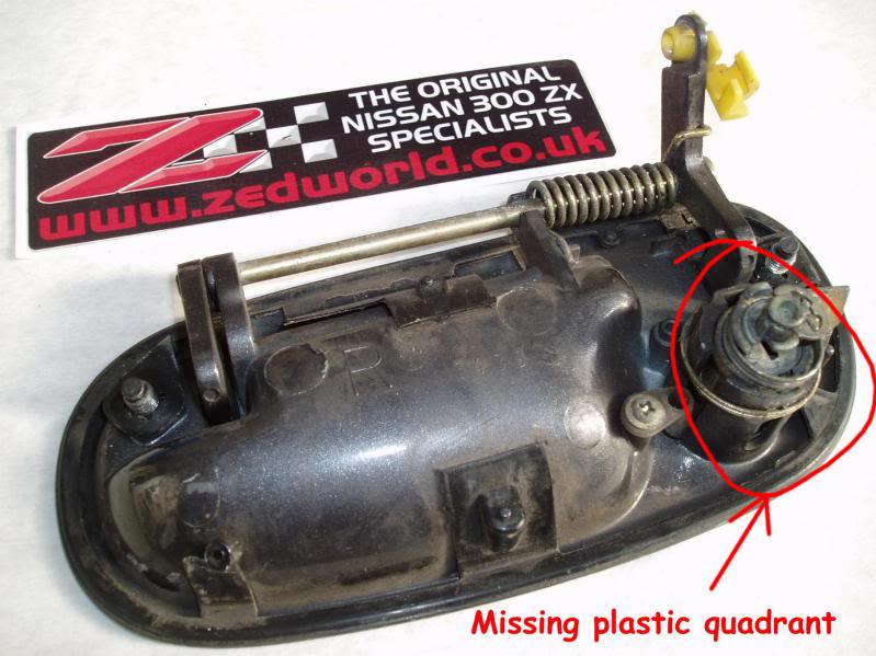

Did you mechanic mention which part seemed knackered? The plastic attaching cam from the lock barrel to the control input rod is a common failure item and when it breaks, the barrel will just spin inside it’s housing without unlocking or locking the car.
my mechanic says he can see bits of springs etc loose inside.
Bet this is what he is seeing, the plastic quadrant broken and fallen away, his view in the door will be severely restricted as on the later model zeds Nissan made some effect to shield the lock mechanism from break in.
