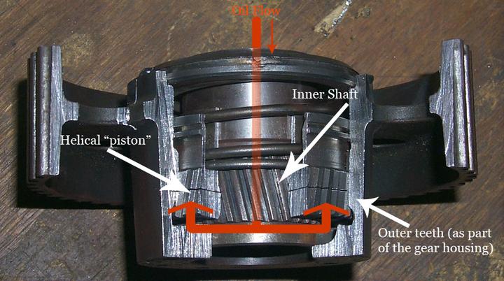

Has he not lost the gears on the front of the engine?

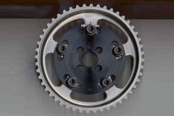

He replaced the OEM ones with adjustable cam gears which i would assume do not have vvt solenoid on them.
Or rather that stuff there vvv
The solenoid is at the back as I understand it.
If his front Sprockets look like this...
I don't see how he can have VTC, despite the ECU and solenoids doing their thing, the camshafts having the oil-ways, I believe he is missing the mechanism at the front.
Unless you have either OE cam gears or BDE cam gears, you cannot use the VTC system. The mechanism inside the cam gears is what changes the cam overlap
