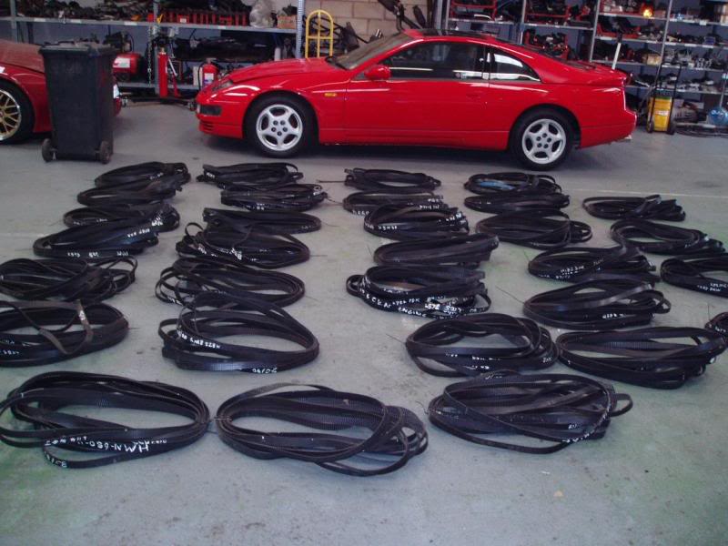

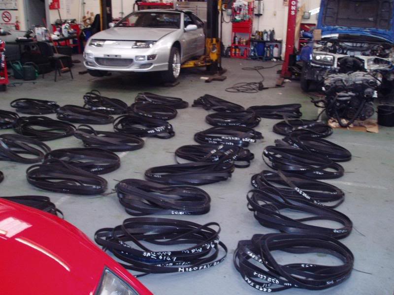

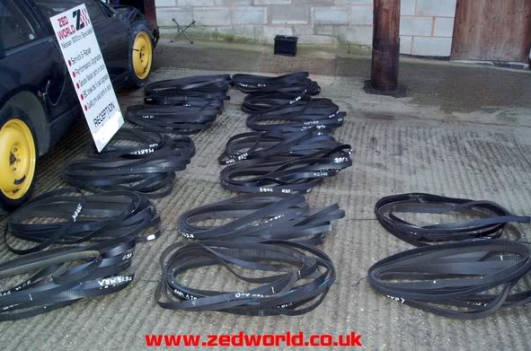

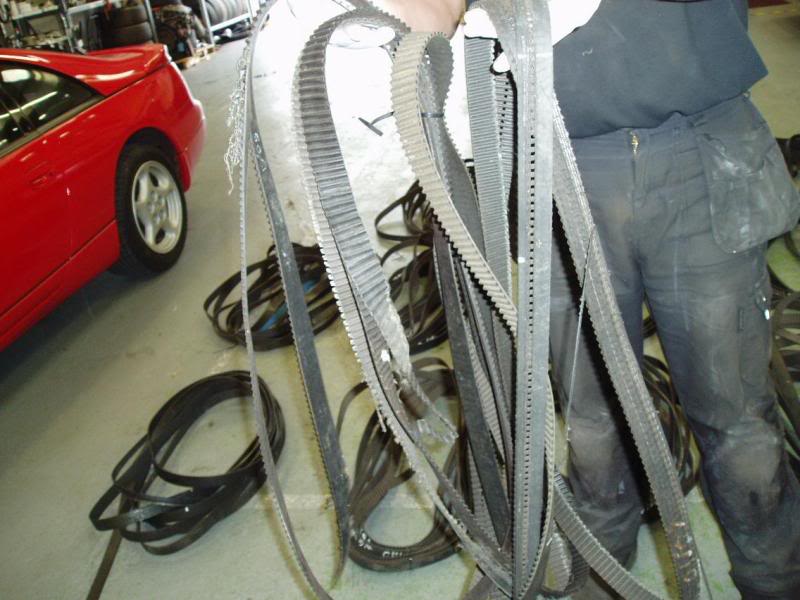

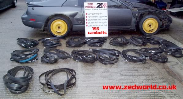

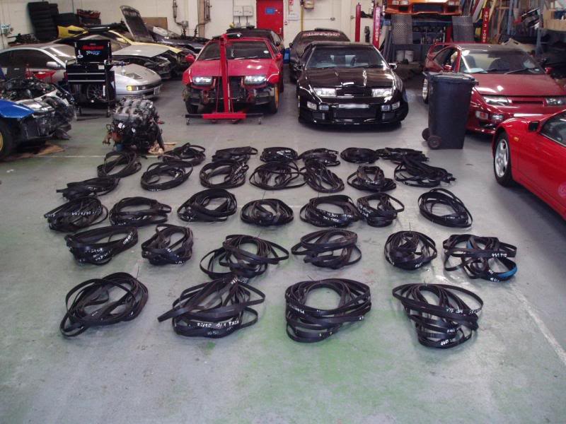

Oh just in case anyone may not know me ( newbies)and is wondering about my cambelt experience on zeds, every single one I changed was documented and photographed, many zeds change hands now with those same photos going with the car.
Over the years I amassed hundreds and hundreds and hung them around the workshop as sort of my scalps !! ( lol !) over the successive years having tot ups to how many we had, eventually cable tieing them in bunches of 10`s and having little guessing games here, remember when I passed the magic 1000 mark and surprised the owner when he came to collect his car as I did it for no charge !!
Anyhow, fill you boots with some pictures>>
Edited by JeffTT

You're winning Jeff... but I'm catching you up :lol:
It was a proud moment in my spannering career... or rather, a few hours later when it started was :biggrin:
These were like "Ksssshk!" and the new ones were like "whsss" haha, it ran like a sewing machine afterwards.
Yes getting there, just 1,499 to go....lol
Jeff
