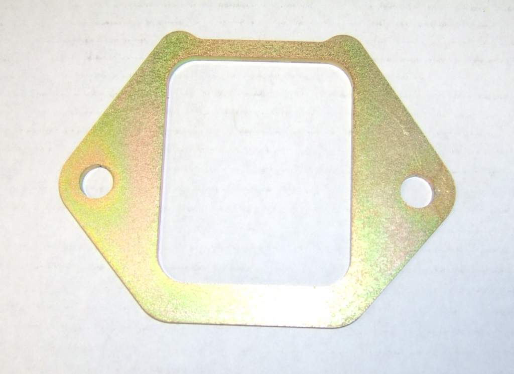

And the spacer plate (TT fly in na box). I used 3mm ally, what thickness to space out did you usually use with a TT fly in na box?
And sorry slightly off topic
3/16 " you can buy the plates already cut >>
https://www.z1motorsports.com/transmission-driveline/ramey/starter-shim-plate-p-2945.html
https://conceptzperformance.com/ramey-z-transmission-na-to-tt-starter-shim-plate-spacer-nissan-300zx-90-96-z32-rmyz-23300_p_2528.php
