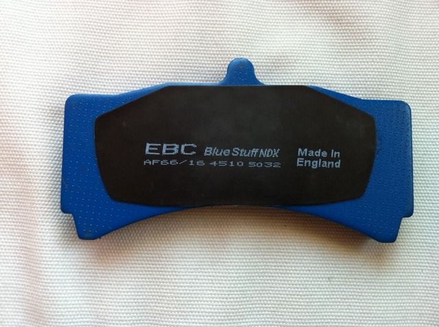

Whats the main difference between Bluestuff & the NDX version?
The DC Performance site I posted above has the Bluestuff pads for £115, doesn't say NDX anywhere though.
Edited by Adam D
Different friction compounds. Bluestuff was their first "race" pad superseded by the NDX type.
NDX pads are marked on the back face as below:
