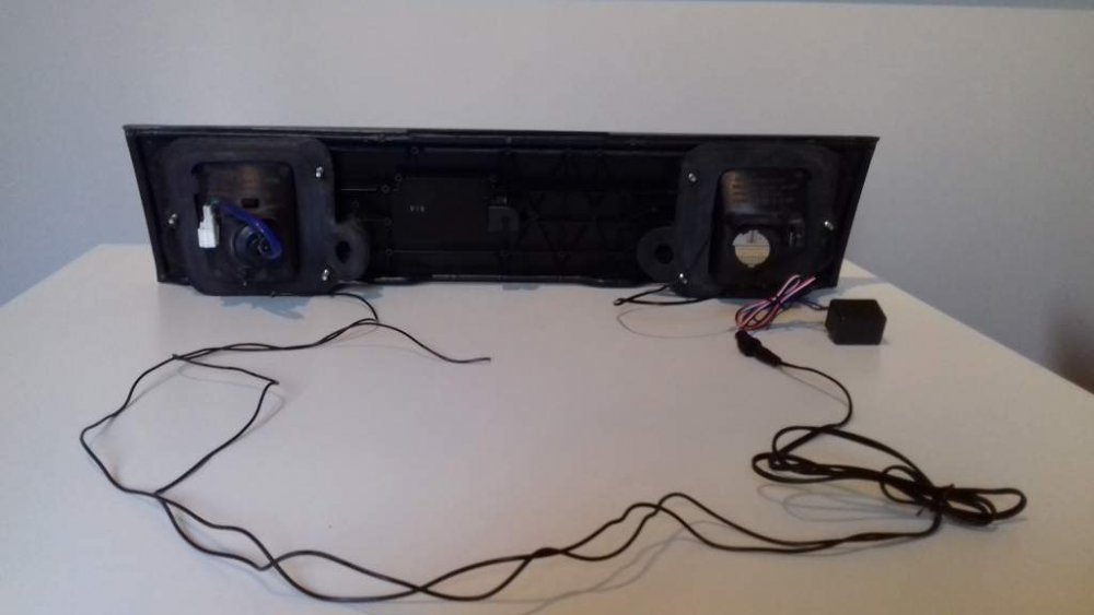

Hi, I've got a rear light centre panel available - it's an illuminated version: bluey green.
If you search past posts, you'll see my original advert dated 30 March 2017. I've added some new pics to this reply.

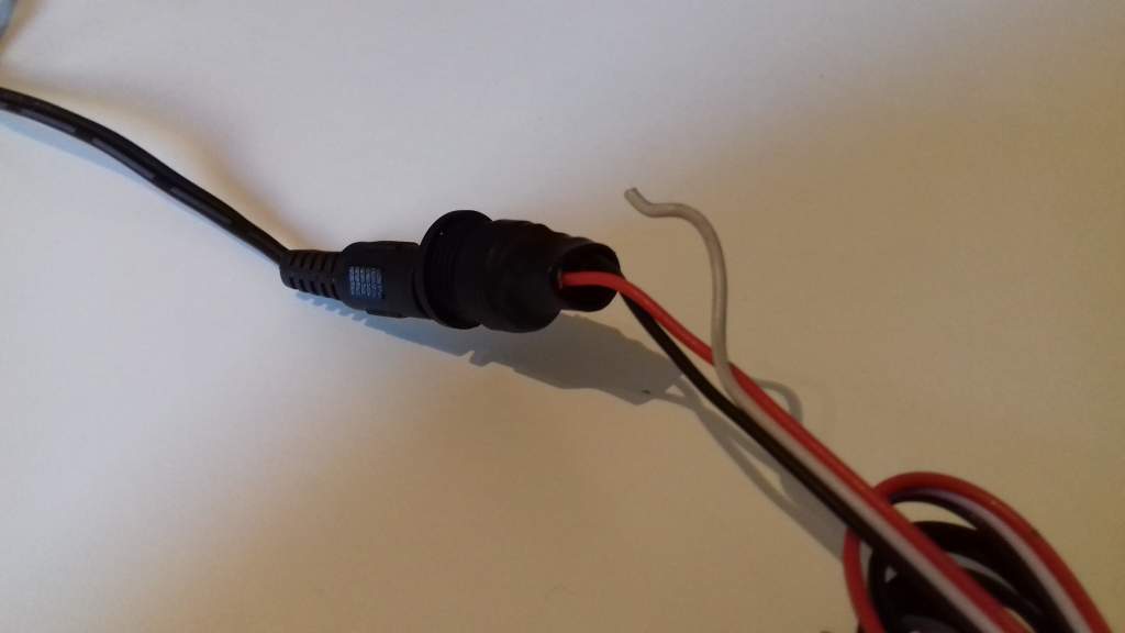

However, please note that back in March this was working fine when I connected it to a 12v supply but now it's not lighting up, I found a broken wire (white-shown in one of the pics) which I suspect is the culprit, connections appear to be set in glue/resin. I'm confident someone with proficiency could repair this easily.
Hope this helps.
Regards
The white wire is just not required, i have invertors exactly like this with the three wires - i can easily see how you'd conclude that this was the culprit though for not working.
So that leaves the invertor, connected to 12v - does it buzz ?
If no then try for a fiver a new one but if yes then the reverse light panel will need opening and you'll need to replace the EL colour sheet inside, unless that is you manage to spot an obvious wire off or such like in the dismantle process.
