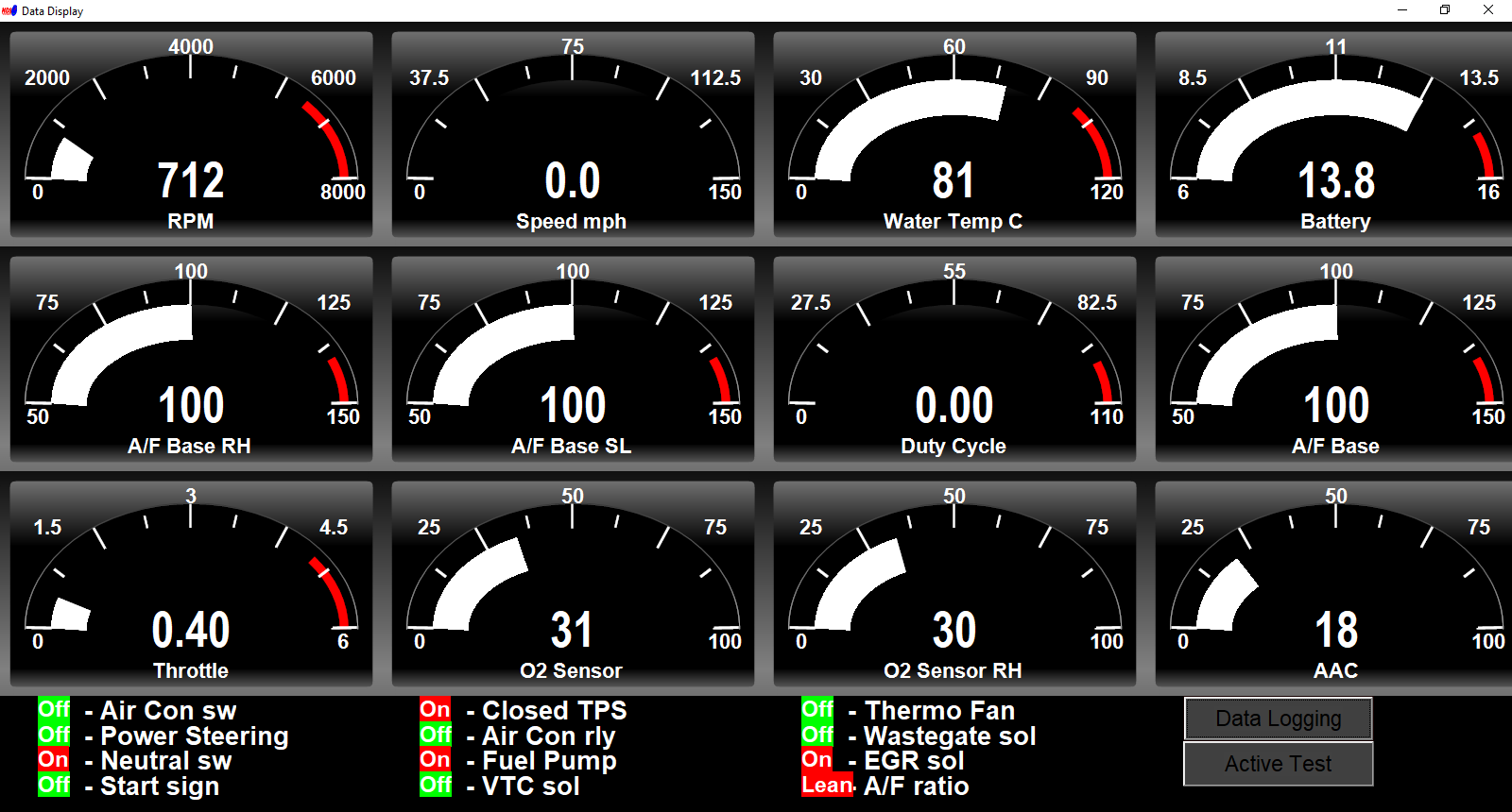

Car has had a full service and "supposedly" a boost test that came up negative. However I have been speaking to various people and hooked the car to Datascan and noticed some anomalies..
The Duty Cycle is blank and the A/F Ration stays permanently on lean even when I take it out for a drive. I thought it was supposed to oscillate on lea and rich?
Checked the TPS and the connection had green crud on it, cleaned it as much as I can but not difference. There is also no difference if I disconnect while engine is running.
No error codes being reported.

So as is often the case with the 300zx looking too technical too soon is throwing you off track, so lets assume you are getting NO boost, nothings past the 0 on the gauge, or maybe a very, very slight bit, if you had a boost leak that big the engine would run very poorly, there is nothing on any of those read outs that can effect the boost to that amount ( no boost ) although the duty cycle been off is odd.
So your should be looking for a basic mechanical issue and that will be a seized turbo, and a seized turbo almost never leaks oil so no smoke ! because the oil feed is compromised which is why is seized in the first place.
Simple check, disconnect the afm, slacken both large boost pipes into the throttles but do not remove, now start engine, remove one pipe completely. pull a latex glove over the pipe coming from the turbo / inter cooler, ( not the throttle ) now raise the revs and if the turbo is working the glove will inflate, if not its not boosting, do both sides and at a guess you will have the most common failed passenger turbo, the boost the other turbo is creating is simply lost straight past the seized one and down the exhaust.

Were your O2 sensors fluctuating when increasing RPM above say, 2,000.RPM.?
Both should be switching between, say.. 15 and 90 approximately.

Either way not going to effect the lack of boost, noticed the egr is showing as active too which is odd, think there maybe be some communication issues.
They fluctuate but not by much. From what Jeff told me on my last Zed, I think I need to change them but want to get the boost sorted first (unless this may be causing it)
