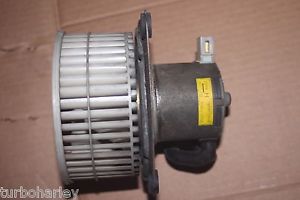

Anyone knows easiest way to get to the cabin fans?
Mex
Mex
Easy job, passenger side behind the glove box area, take a look at the picture below, it shows the fan and the fixings as if the glove box lid was removed. ( will look slightly different as that is a lhd zed )
You do not need to remove it to get to the fan and its fixings, but makes it easier, there is a duct pipe that can be removed to help, look up from the passenger foot well and you will see it.
Second picture shows what the fan looks like when removed.

Amazing Jeff, thank you.
Will give it a go at the weekend, or maybe one evening as I want to drive it more and more before it disappears for winter.
Mex
