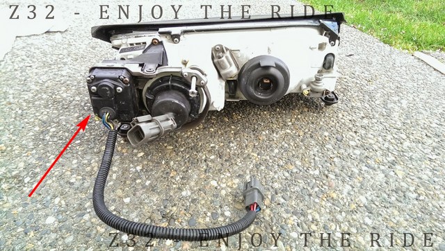

You mean like this?
[ATTACH=CONFIG]108005[/ATTACH]

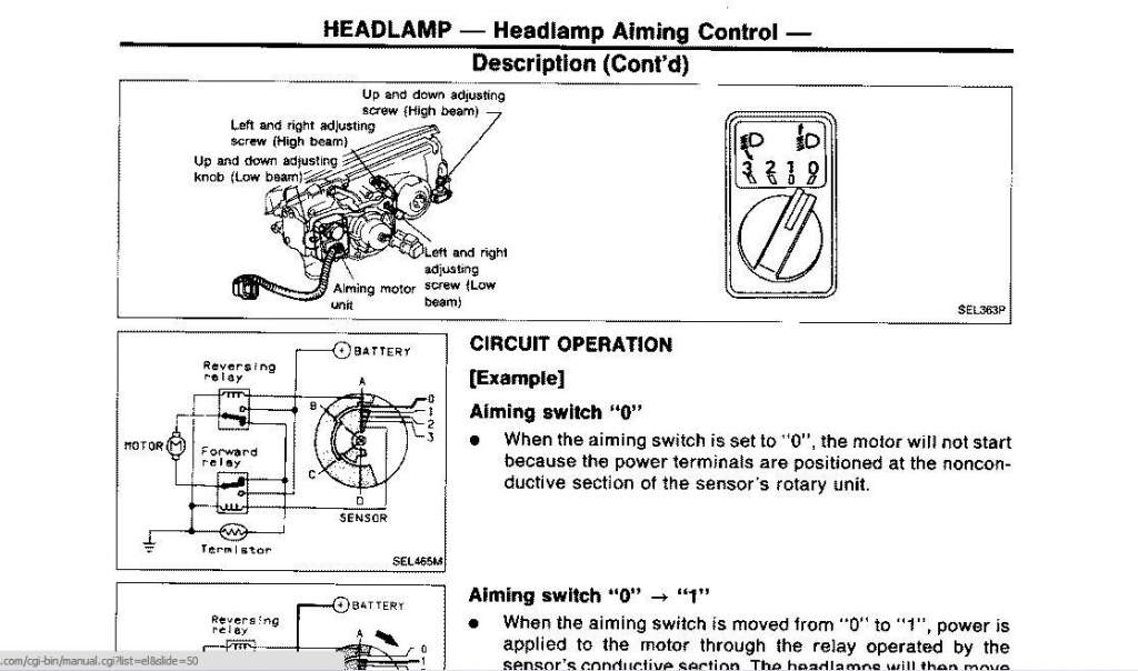

then more info here:
https://z32enjoytheride.wordpress.com/2015/07/
Those are level actuators as fitted to some European models, not dimming.

Sorry for the confusion. There probably are no solenoids and sensors lol. I have no ways of checking as the car is 2 timezones away. Thanks for your help guys its a lot more clear now
