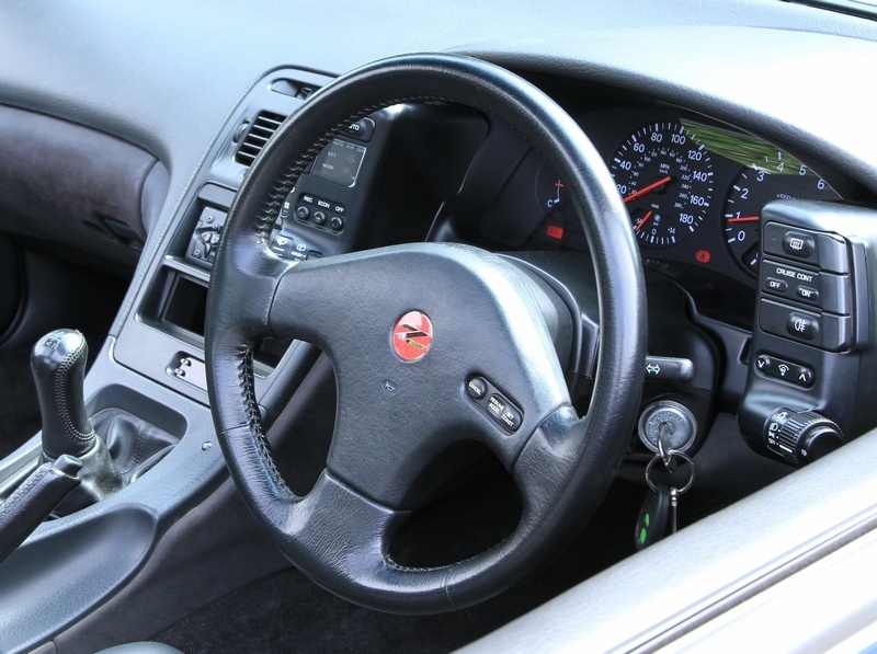

Final little project was to see if I could find a steering wheel I liked.
I have been running an old nardi wheel which I have owned for ages, it was ok but a little scruffy and the grey didn't match.
I managed to pick up a used but good condition momo Nero wheel for reasonable money.

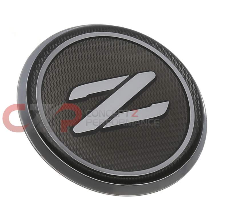

I generally like this wheel as it's a pleasant shape, has a couple of silver accents that help to link a few other bits of silver in the interior and it isn't crazy modern. A few things that I don't like are the centre boss cover and that the suede is black.
The suede inserts were changed over to charcoal alcantara, a simple black centre ring was added and the horn button replaced for a more subtle on with no yellow.
I'd be interested in people's opinions on this as I'm still considering going back to stock.
Not this again guys. Everyone knows you need a textured OEM badge. None of this goofy ebay badge nonsense with an oversized logo.

I have no words [emoji15] Has to be my favourite car in the club, for me this is the most desirable Z32 in the UK (at least), great work as always Pete.
And yes, stock wheel with a BLACK and silver Z badge, none of that pink business that those guys have!
Very high praise indeed sir, thankyou very much. I have to say that I don't think the paintwork will be up to the same standards as your's or funky Si's ( and quite a few more perhaps) that will all be sorted in time though.
