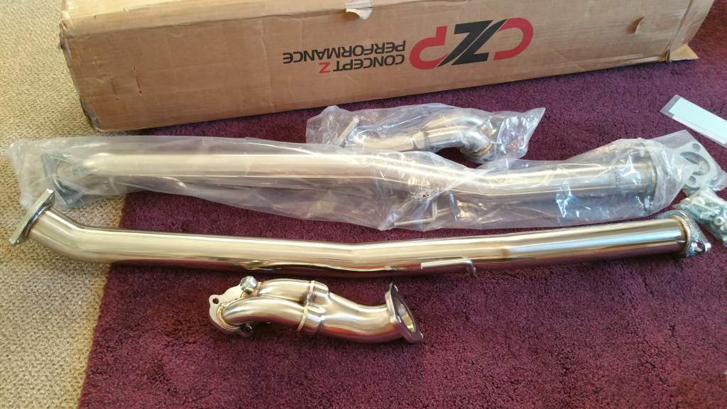

Wasting money on the Z1 downpipes IMO. Megan ones from CZP are almost $100 cheaper, just had them fitted to mine. Jimmer advised me not to bother with Z1's in the past and get Japspeed, and thinks the Megan ones he's just fitted are a good alternative to Japspeed's
https://conceptzperformance.com/megan-racing-v2-4-bolt-downpipes-nissan-300zx-90-96-twin-turbo-tt-z32-mr-ssdp-n300-v2-dp_p_28564.php
Valid point Chris.
Do they have the wideband fitting at the exhaust flange?
What was Jimmers main criticism?
Yep mine did. I don't want to put words in his mouth but I think he thought Japspeed ones were just as good basically. If it makes you feel better even Funkysi said Megan products are normally alright when he looked at mine :biggrin:
