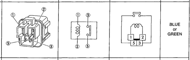

Now if I ground pin 1 on the relay the fog light comes on, should that be correct?
Also if remove the relay and I link pins 1 & 2 then 3 & 5 then put 12v to pin 1 it also turns on the fog light?
Under both circumstances the switch doesn't alter whether it's on or off.

I've updated the FSM wiring diagram to include the pin numbers on the relay.

I get power to the fuse and relay, so guessing the switch completes the ground circuit rather than supplies power? Correct, switched GND to pin 2.
Now if I ground pin 1 on the relay the fog light comes on, should that be correct? I assume you mean pin 2? If you ground pin 1 you will blow the fuse
as it is permanent +12v.
With the relay in place, if the rear fog light and the tell-tale light comes on by grounding pin 2 that shows relay is OK and that the "load" side of the circuit
is working. The fault is on the switched GND circuit from pin 2 back. E112/M59 to M14 diode pack and then back through the rear fog lamp switch and the
lighting switch (in the headlights on position).

Found there is a break in the ground wire running to pin 2 on the relay, going to splice in a new one when I get a chance
