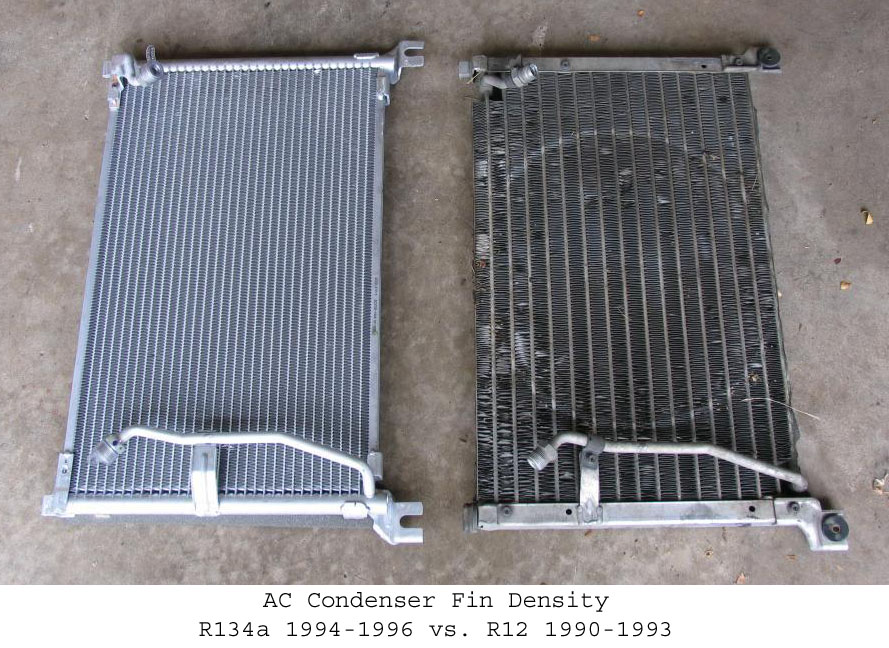

You want the condenser from a TT (NAs have different pipe work). The condensers from later TTs are more efficient (part #92101-47P15).
https://conceptzperformance.com/nissan-oem-ac-condenser-twin-turbo-tt-nissan-300zx-90-96-z32-92101-47p15_p_7232.php

Thanks Andrew...I take it the later model has the same pipework/connections as the earlier model?
Gary
Yes, but read CZP description re piping.
