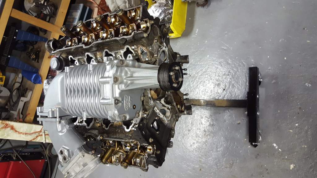

So......in the end i went for a 1993 RX7 FD. engine is being mounted at present. Also i got hold of a Eaton M112 SVT blower from a cobra mustang. Should go well :laugh:

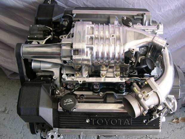

Something like this?
[ATTACH=CONFIG]108885[/ATTACH]
The blower in your picture is a M90 charger Andrew. A bit smaller than this one.
