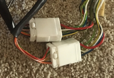

Black curled wire - Ground?
External from the original wrapping?
Assuming red to red? Think goes to Ignition source?
On the injector wires, assuming just need to reconnect
if this is the injector wiring like I think, there's only 4 wires? Should there be 6?
The the main wires are just cut like in that photo.
Then there are spare wires which seem to be extensions of the injector wires?
Oh I do hate wires ?

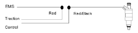

The injector circuit(s) are of the form:
The wires are cut for each injector circuit. For the ABS connections the wires are spliced.

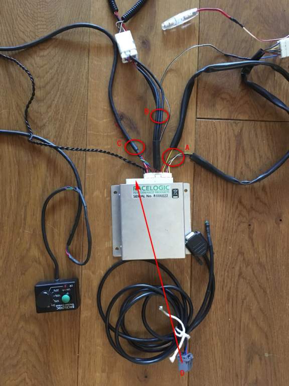

It all looks there to me. Group 'A' are injectors input/output. Group 'B' are to ABS circuit. Group 'C' are Black box control.
Group 'D' is diagnosics loom (to a PC).

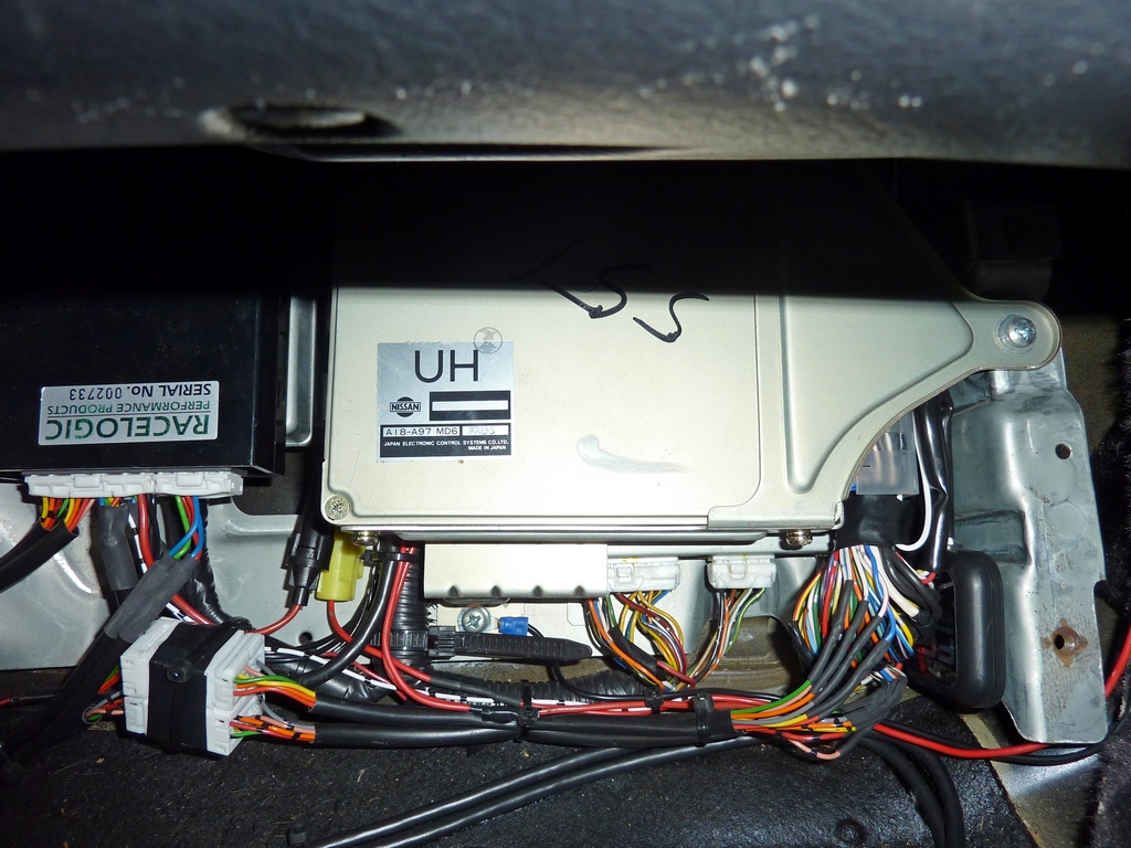

By way of reference, this is my install under the kick panel in the passenger footwell.
Edited by AndrewG

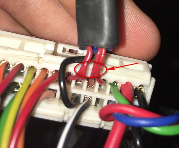

Ah! After studying your photo Andrew I have determined where I was getting stuck. The ABS wires appear to have be re-done by the previous owner
Not following the correct colours with the guide.. is there any chance that you know which pin is the right colours for the guide? Red/green/Yellow/Blue?
It dosn't actually matter. My system did have the four colours for each ABS sensor. However the system is smart enough
to work out which wheels are driven (rear) and which are reference (front) and then left and right. This is covered in the
manual (page 18) "Calibration". You can also setup and check manually (using the Windows RLTC software) which RLTC
ABS channel is connected to which of the four ABS sensors (pages 48-50) "Wheels".
If you want the RLTC to do the wheel calibration automatically you will need the calibration adapter (see below). This is
plugged into the diagnostic lead during calibration. Otherwise do the setup manually.

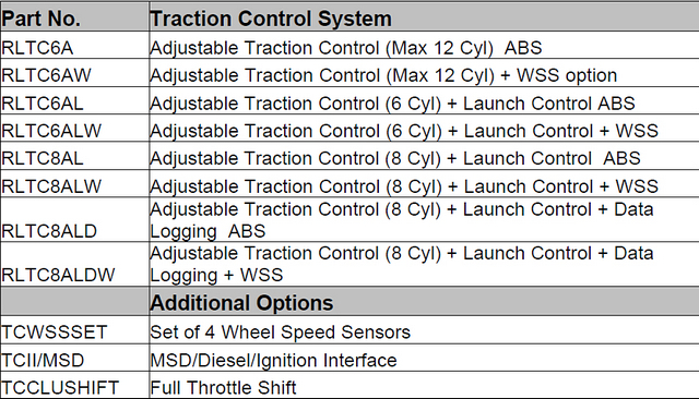

You are quite correct they are different systems. Racelogic sold thousands of RLTCs so there are many advocates. They
are not specific to the Z32, so you can buy a s/h system and fit it to a Z32 (even if it came from a 4 cylinder car) as two
models were made - 4/6 cylinder and 8 cylinder.
The product details are still published on RL's site:
http://racelogic.co.uk/index.php/en/racelogic-products/other-products/racelogic-traction-control

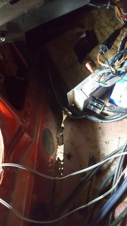

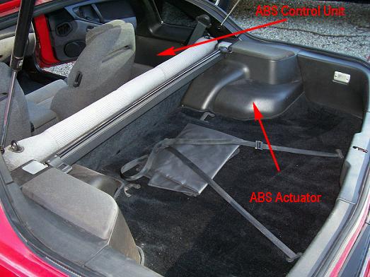

Okay made good progress but hit a road block! Where is the ABS unit in my LWB [emoji23]?
Edited by Evaansss
On the rear, the left hand side, where the left rear speaker is.
Right hand side unless its opposite for US specs?
Okay made good progress but hit a road block! Where is the ABS unit in my LWB [emoji23]��
The ABS control unit is on the right hand side behind the drivers seat 3/4 trim panel as shown
below (the location of the ABS actuator is also shown for reference).
