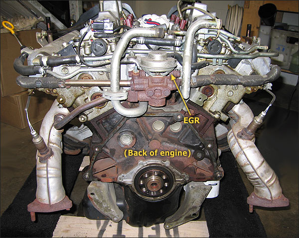

Images of the rear of the engine and the 2 coolant hard pipes.
