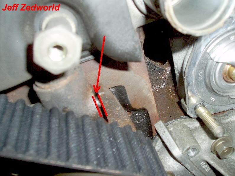

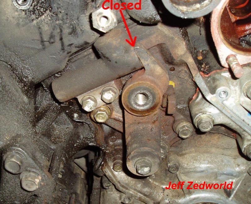

Ok I am back, so the most likely cause of the belt slap and subsequent vvt noise is an incorrectly tensioned cambelt, now this can be made worse by a noisy pulley but in 99% of cases the root cause will be the tensioner.
So what goes wrong and how come it goes quiet after a while, so see the first picture below of a tensioner closed up fully, I came across this many times when changing a zed cambelt. This is usually due to been incorrectly fitted by a mech or owner who has not understood the set up procedure when replacing the belt, I will add I did one that had come from Nissan main dealer like this so dont think back street garages are the only one` to get it wrong.
There is an amount of preset that is required, the reason been is the belt is a moving part and grows with acceleration and temperature albeit a small amount. The belts have a significant inbuilt stretch specification, the first and most important one is when a new belt is fitted and run up for the first time, this is manufactured in and will set the rate at which the belt performs over its lifetime, this is why you should NEVER reuse a cambelt once it has been removed even if it is low mileage, that initial stretch parameter is done and will not return.
So looking at pic two the tensioner has been set with a gap just less than specified by the Nissan ( come back to that later ), this allows the adjuster to be a free floating tensioner that can not only extend out when accelerating the engine speed or as temperature of the belt rises, but just as important is when the belt is cold it has room to move in and lessen the tension accordingly but be ready to extend out as required.
So now we know how it works it all starts to make sense if the tensioner is set in the fully closed position when fitting the belt it can not retract when it needs to and no longer is a floating tensioner but a solid adjuster with no give, this lack of give causes the belt to slap and the vvt cams to shudder and hence produce the noise from both the vvt pulleys and the louder noise from the belt itself.
Remember I mentioned the adjuster in pic two was set below the setting recommended by Nissan? yes well that is because as you rotate the engine for the first time with a new belt on, the belt settles and the adjuster moves out to the correct position, if you set it as Nissan suggest from the start the settle position leaves the tensioner open to much.
Of course a seized tensioner can have the same noise for the same reason even though it looks to be extended out from the set position, for this reason the belt MUST be removed to check.
Finally, why does it go away when the engine gets warm? easy the belt grows a little when its warm and gives a little slack back to the tensioner, that is a sure sign of a tensioner set incorrectly as a seized one will still not move.
Hope that helps Gio
Jeff
Edited by JeffTT

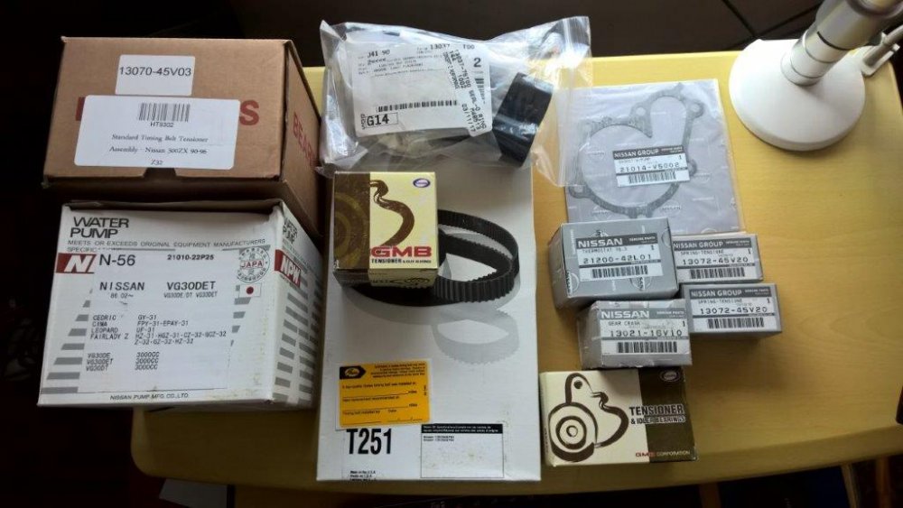

Bullet dodged, thanks to Jeff. Which is kinda fitting since he did the UK thing on this Zed a few years back. (And looked after my other 2 Zeds.)
(Also thanks to Lymon for the ConZult and Eurospec for fitting in the inspection so quick.)
Floppy belt as suggested by Jeff. Possible failed hydraulic tensioner. Parts ordered from ConceptZ. And I'm back home giving thanks no disaster when we went to IoW last week or last month ferrying sick kittys about.
