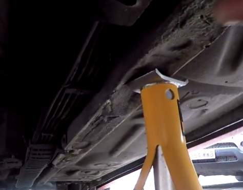

there is few surface rusts but the worst one is, driver side rear sill that needs welding. After running it for around 5-6 hours smoke has started appearing from passenger side turbo so I think the engine is going to be going out soon for the new turbos.
