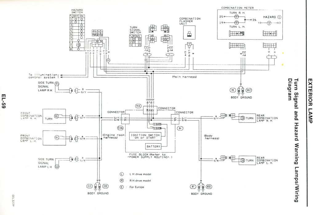

Had a look at the circuit diagram from the FSM EL-65 (which I have attached) to remind myself. You can see that before
connector M10 the indicator circuit is only routed Left and and Right through the Hazard and Indicator switches. It is only
after M10 that Left and Right is split into Front and Rear (connectors E106 and B4 respectively). More thinking required.
Yes more thinking required. I have no LED bulbs - all standard. So, it can only be something to do with the body ground or the connectors - as if the side lights work but the indicators are shorting/grounding or something else (to replicate a short) - it must be do with the wiring. Maybe a replacement loom from the connector is the way forward?
So a few hours tonight of further investigation and it is definitely the looms - corrosion I would imagine, as they were working before the winter. Anyone got any looms spare at all? They need to be able to accommodate twin filament bulbs rather than single filament ideally.
