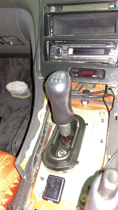

It must have done, I don't think it would work without as there would be too much slack to shift. The (i think) m8 bolt that goes through the bottom of the shifter assembly goes through a sleeved hole in the base of the shifter, surrounded by some nylon bushing and enclosed by a pipe section. And the central balljoint without the plastic bushing would just knock around. Can you provide any pictures of what you mean?
I don't know if i'm making and sense :lol:
And sorry I can't find the rest of your plans. Radiator out for replacing belts/cambelt or what? hmm
They must have just disintegrated that badly. There was definitely less slack when I first got the car.

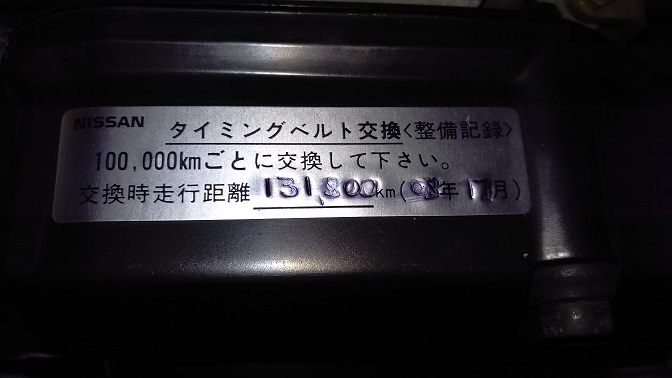

Yes, doing the 200,000 KM service.

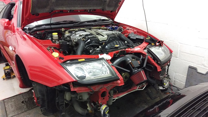

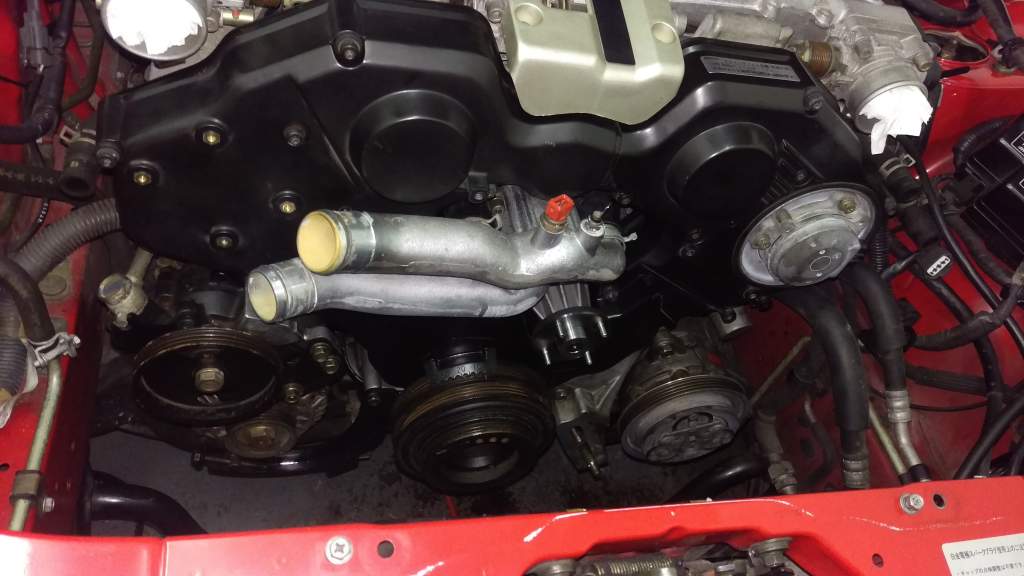

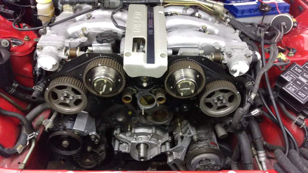

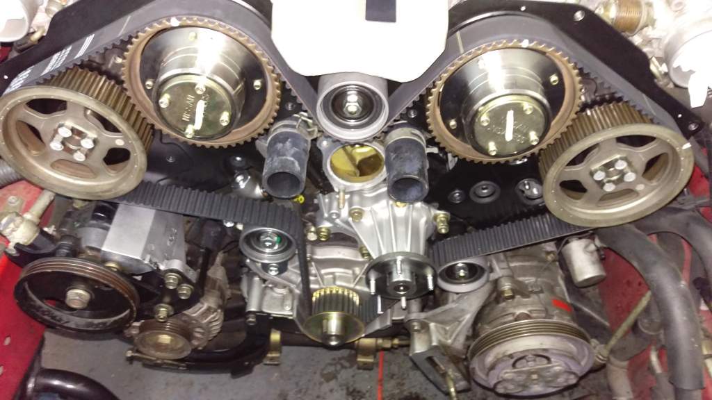

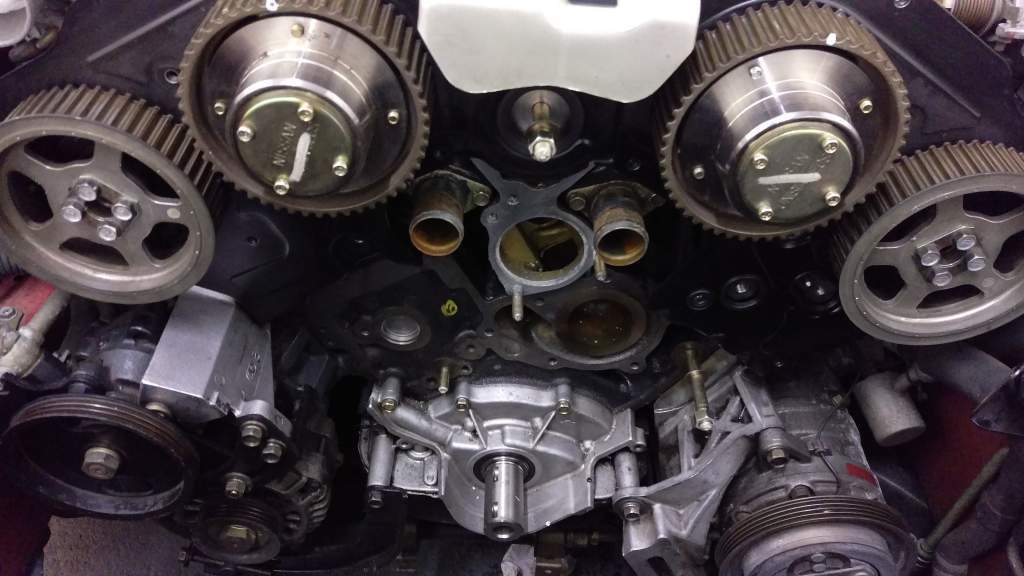

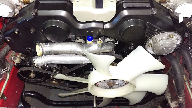

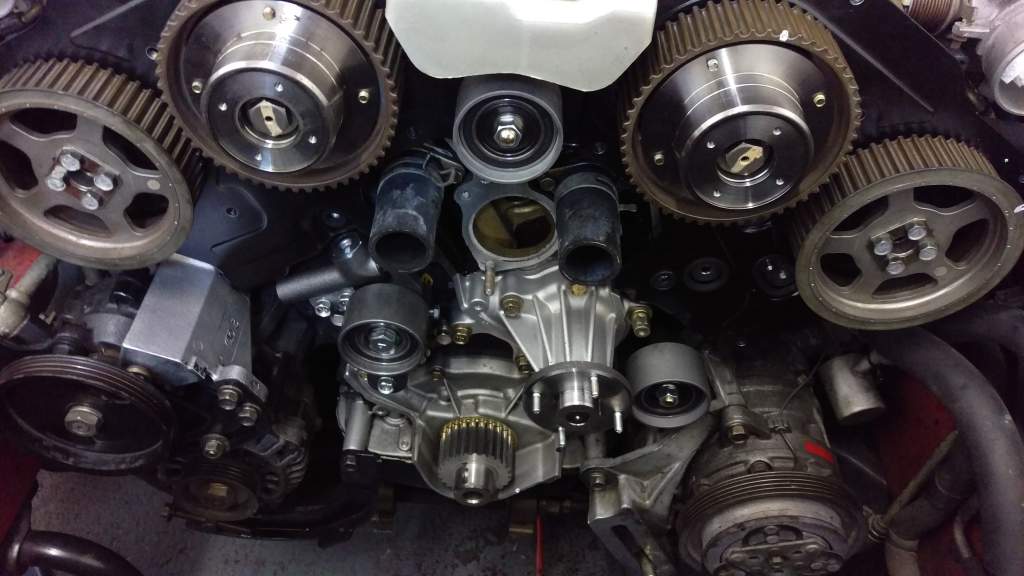

Continued to strip it this week, with lots of polishing.
Belts, pump and pulleys still look fine.

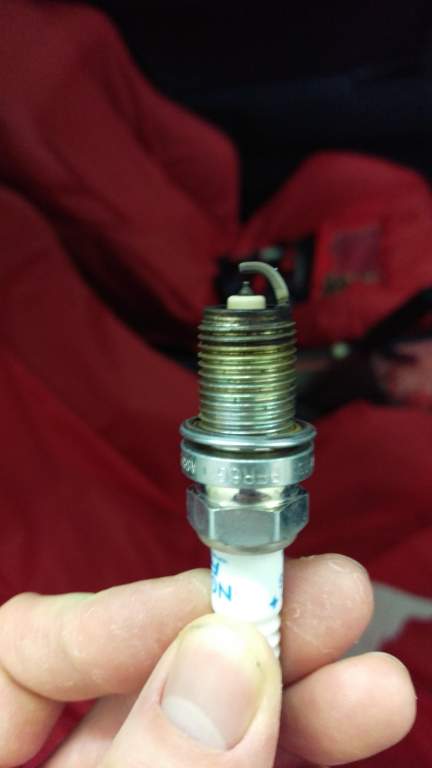

As does spark plug #1.

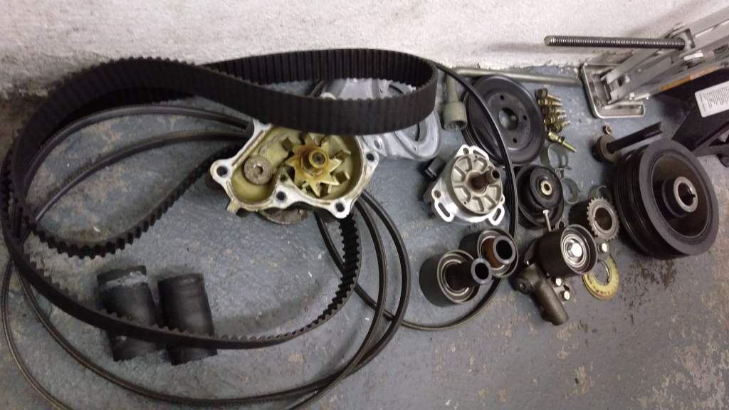

131,814 KM
New OEM interior leather gaitors
New OEM timing belt
New OEM timing belt tensioner
New OEM idler pulleys, studs and nuts
New OEM upper timing belt cover seals
New OEM water pump with Z31 gasket and studs
New OEM coolant bypass hoses
New OEM thermostat
New OEM cam seals
New OEM VTC springs and seals
New OEM crank seal
New OEM crank sprocket
New OEM crank spacer plates front and rear
New OEM crank woodruff keys
Probably forgetting some bits there. I didn't contribute much to most of that work but I'd feel confident doing it alone in future.

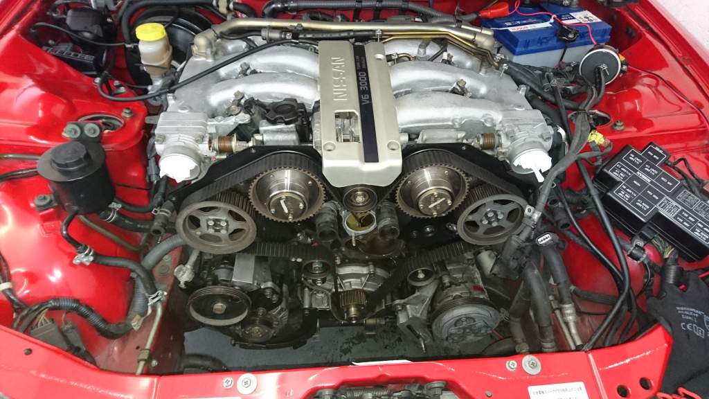

Wasted about an hour today - plugs needed to come out, and I managed to drop a bracket bolt down hole #1 :( had to drive around a bit before buying a rather expensive magnetic extractor.
So just to fit the other belts and pulleys, then the radiator. Probably have that done tomorrow then spend about a week putting the body parts back on. In the mean time, I need to repair the intercooler air guides, rebuild the shifter and replace the coil pack connectors using the CZP kit.

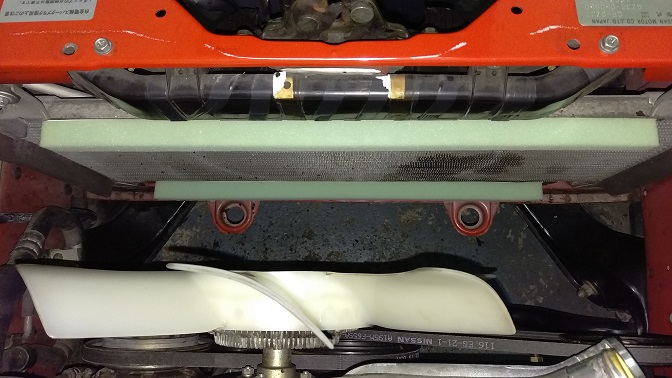

The engine is now back together, including new coolant temperature sensors, radiator cap and shroud screws (several were missing). Also some fresh insulation foam for the condenser. Started it about an hour ago and warmed it up - perfect idling. Unfortunately I couldn't rev it much as the interior is still torn apart so I can't disarm the immobiliser!
Got about 7L of fresh coolant into it - I didn't think the block had drained that much. It started to overheat a little (not sure if the thermostat had opened, but surely It must have) and I ran out of coolant, so had to leave it there for now. Changed the oil and filter anyway, and I'll pick up more coolant tomorrow.
Edited by dutchgold92
Probably air in the system, gives a false reading on the gauge. Complete the coolant bleed and fill process and it will go away.

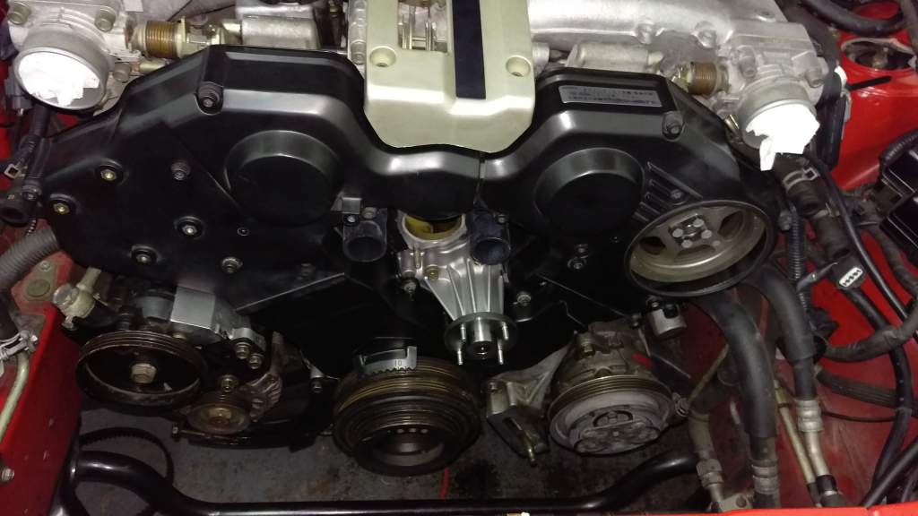

Almost back together now. Running very well - perfect idle.

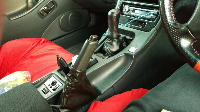

Shifter turned out to be too good to be worth rebuilding, so it just got the new bushings with a collar thanks to Ali. Just picked up an upper dust boot from Nissan as the existing one had some small splits, so I'll get that on today and get the rest of the interior back together.

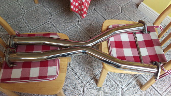

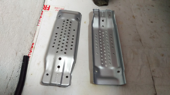

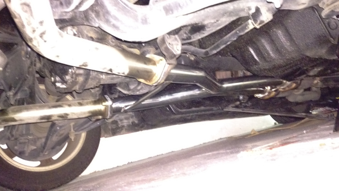

Since a spanner is stuck on top of the cats, we decided to finally fit the Japspeed X-Pipe to match the back boxes. Polished these up and also gave the cat undertrays a quick clean and paint. I've just picked up some new exhaust bolts (only available in packs of ten - cost me €60!) so this can be finished possibly tonight.
The stock pipes are still fine, but naturally they won't stay that way for long in this climate.

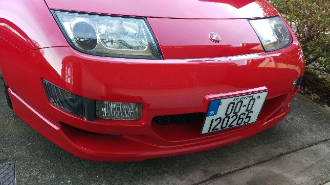

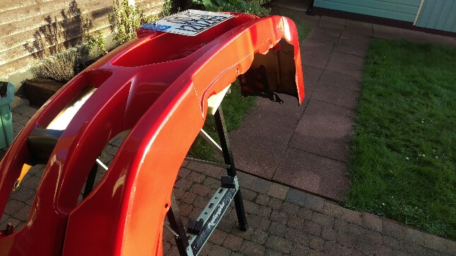

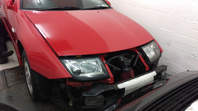

Barring no more delays, the car exits the garage this weekend so I can refit the RH intercooler air guide (needed a crack repaired) and front bumper then, and that's it finished!
Interior and exterior all back together. Underside of the bumper was quickly sanded and sprayed over some scratches.
Took me about five hours to fit the bumper today. It really wasn't so bad other than the screw from hell (beside expansion tank) and bloody hands - perfect alignment from the first couple of bolts. I don't see why so many Americans struggle with that.

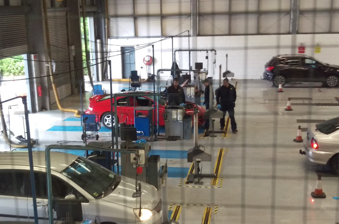

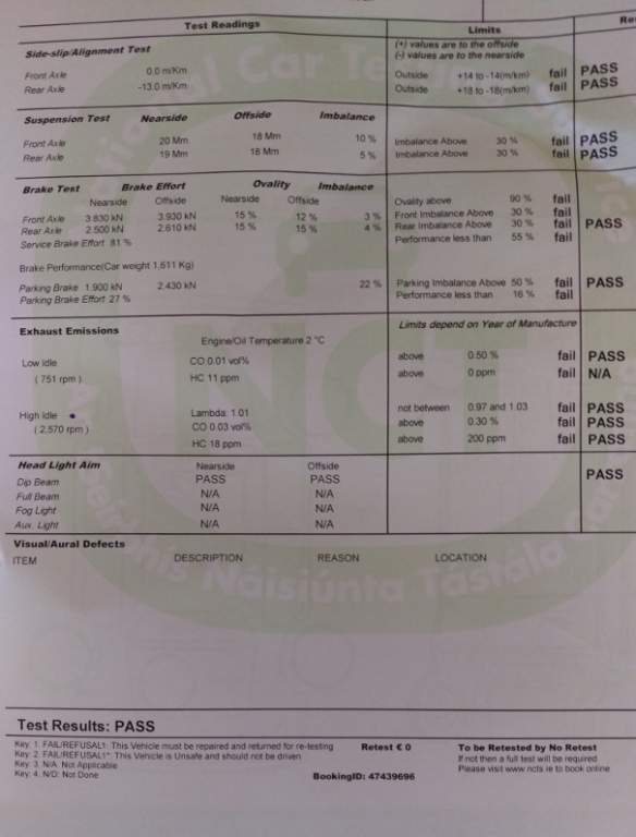

Took the car for its third MOT equivalent since it immigrated. Apparently it needs three testers :lol:
Passed, as usual. The tester mentioned some slight play in the passenger side steering arm - thoughts? There's no movement in the wheel on either axis if I push it by hand anyway. Also, the figures from the rollers don't look quite as good for the rear axle. I assume that's just the LSD?

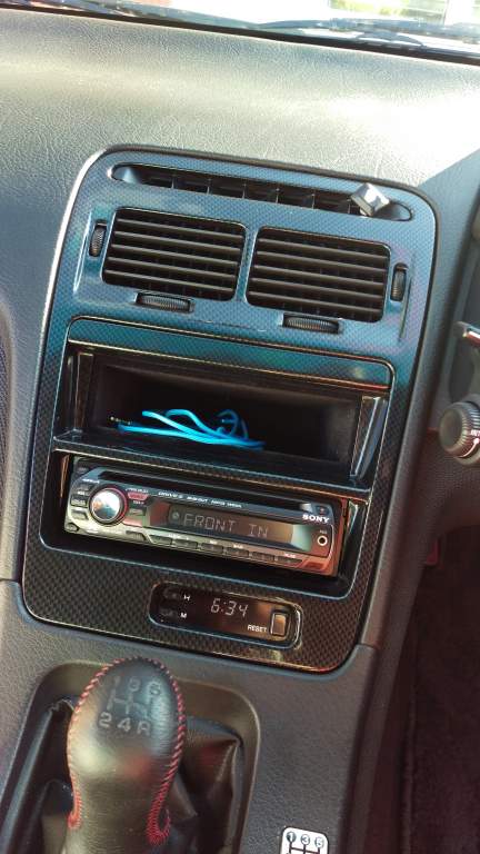

Fitted this today: a genuine final version R radio bezel. My original one had all fixings perished and the vents were broken; apart from typical damage to the top screws holes on this one, it's perfect. It's a shame they're so brittle, as both look perfect.
Cost about €170 from Japan. Plain black ones are almost that much new, so not a bad deal, I think.
What is the thing sticking out of the top vent?
Alarm LED. I'm not going to drill a hole through this so I think I'll just stick it in place.
