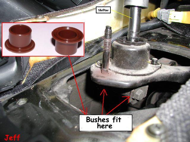

Gear linkages could probably use replacing as they feel a little sloppy. Engage absolutely fine but does feel like there is a small lettuce where the linkages should be haha. Decent mileage though, under 80k. As ever it's a project, but hoping I can bring it back up to scratch.

That all said, if bought as a project and at project price then your going have some fun getting it back to a worthy zed, as far as the gear lever excess movement you mention. That is an easy repair and done from inside the car, it needs the nylon bush inserts changing, under a tenner for both so happy days.

Thanks Jeff! Affordable fixes always welcome! Yea I did check the MOT history before buying online and noticed bits and bobs that are bound to need looking at. Will get the bushes ordered so hopefully get that ticked off
