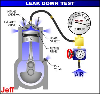

Do a leak down test will narrow it down for you.
Jeff
Sorry for my ignorance, but what exactly is a leak down test?

The reverse of a compression test really, where you pressurise the cylinders with air and see what leaks down past the pistons
