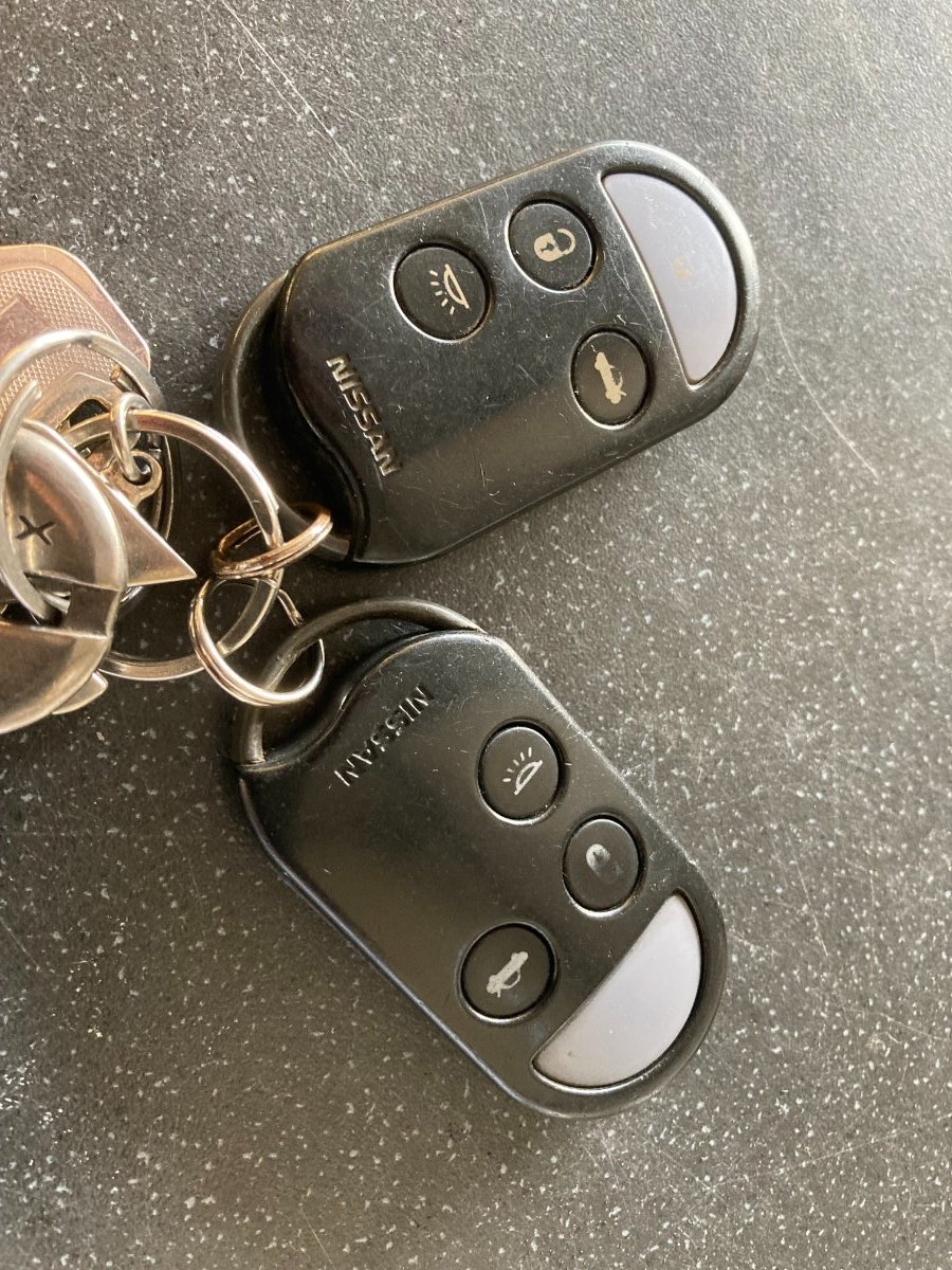

Having migrated the working keyless system from my donor LWB 1995 car into my SWB 1995, I found that one of my four remotes worked straight off, so that's central lock and unlock the doors, pops the tailgate and the fourth button turns on the courtesy light.
I wanted to program my other remotes, yes Nissan are having a laugh with the key in and out procedure in 10 secs but I must have done it because I now have 2 working fobs, so I put all the best bits together with these and here they are pictured.
1 remote I have is not genuine, cannot get anything out of this only the LED lights up and the other genuine one, does actually beep when a button is pressed but no joy linking with the car sadly, can only presume the PCB inside this is not compatible.
