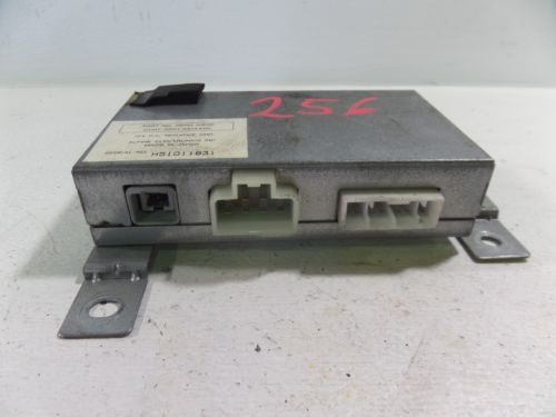

Hi Guys, sorry to Hijack - where is the control box for the remote?.. I only have the ecu under the passenger footwell
Have a look at the service manual? I think it only mentions the ecu in the footwell, seem to remember that's the only thing it mentions with regards to fault finding so maybe that is the receiver? Seems a bit odd though...
Factory fitted or aftermarket? The US (LHD) '96 FSM has the factory fitted Keyless Entry Module fitted along with the ECU under the
passenger footwell carpet (click --> el-271.pdf) and looks like this:
That's what he's got I think, he's asking if there's a separate receiver for the remote signal
