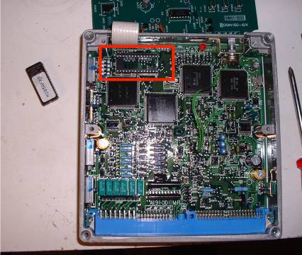

Provided everything else is set up ok, the n/a engine will benefit from a small adjustment as I said, the main deal here is with no forced induction the load is way less which means long term will not be a problem. When you fit those headers you will notice a real big difference how it revs and pick up, all of the mods you have will work together very nicely.
The original eprom ( chip ) will soldered to the board and the best way to deal with this is find an electronics shop / workshop that will do it for you, we always used a company who did ecu repairs so knew always did a great job, get them to fit a socket and from there on you can just plug in the new chip, should not cost more $50.
Have fun
Jeff
