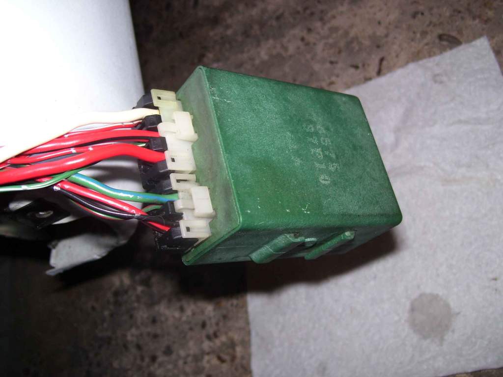

Finally, I have found the reason for my intermittent fault with my Dim-Dip lighting.
After what has been a painstaking search of the wiring, I tracked the problem down to a corroded connection (what a surprise) to the Dim-Dip unit itself.
One wire was barely connected, and fell off when I touched it, and another did not need much encouragement to break off either.

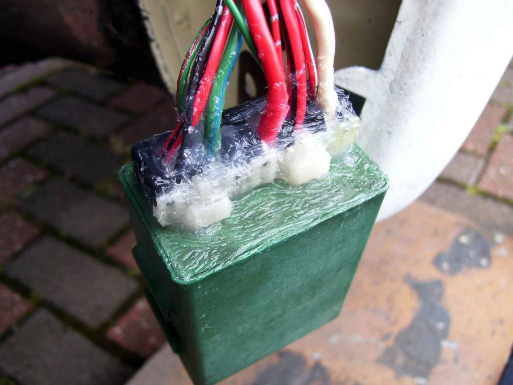

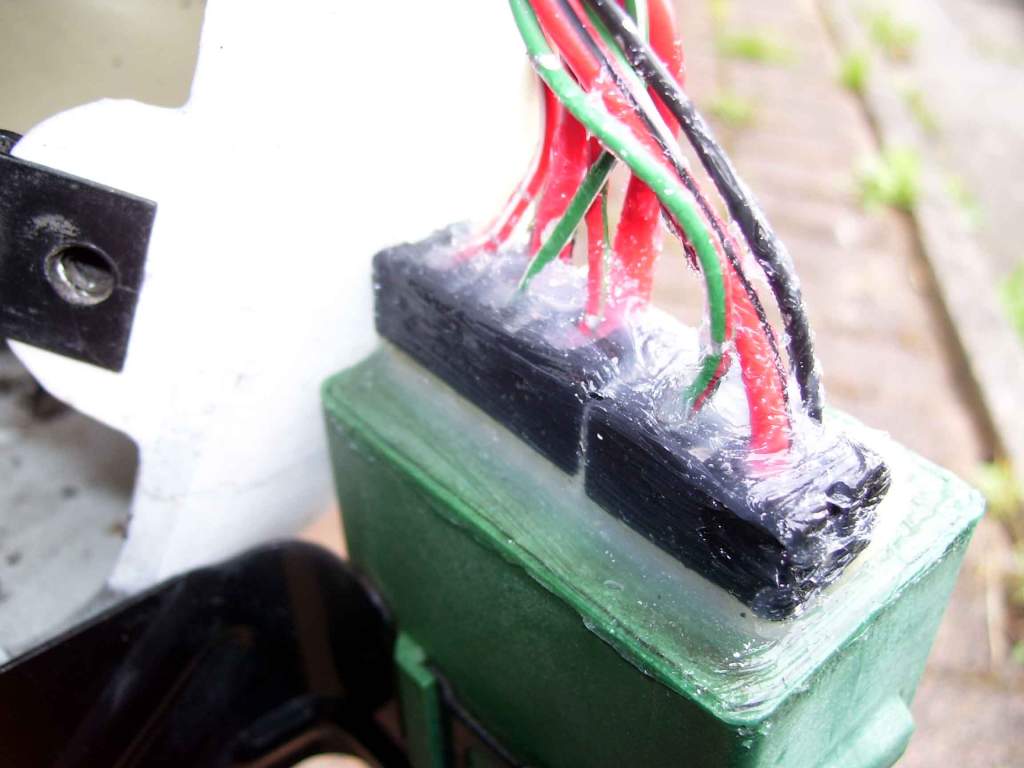

Even gave the Dim-Dip box itself a little wash and brush up.
Question... What should I treat the connectors and box with so as to protect it from the elements?
I'm tempted to brush on some Dielectric grease to prevent a recurrence of the corrosion.

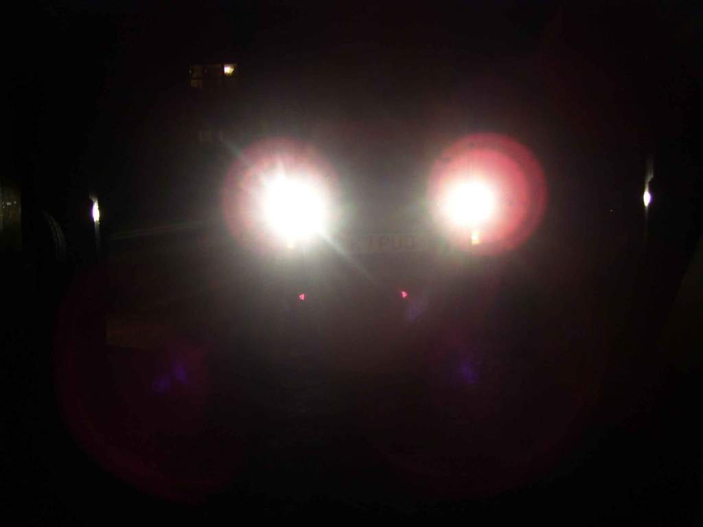

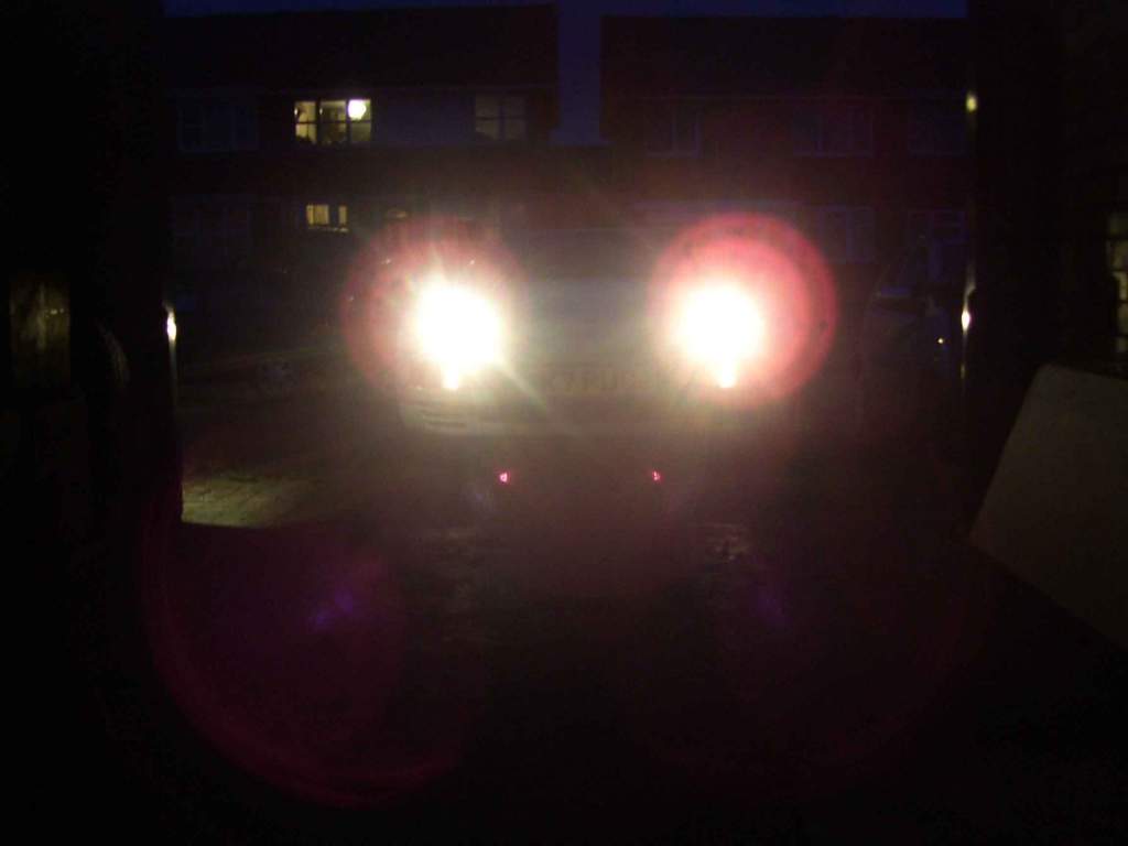

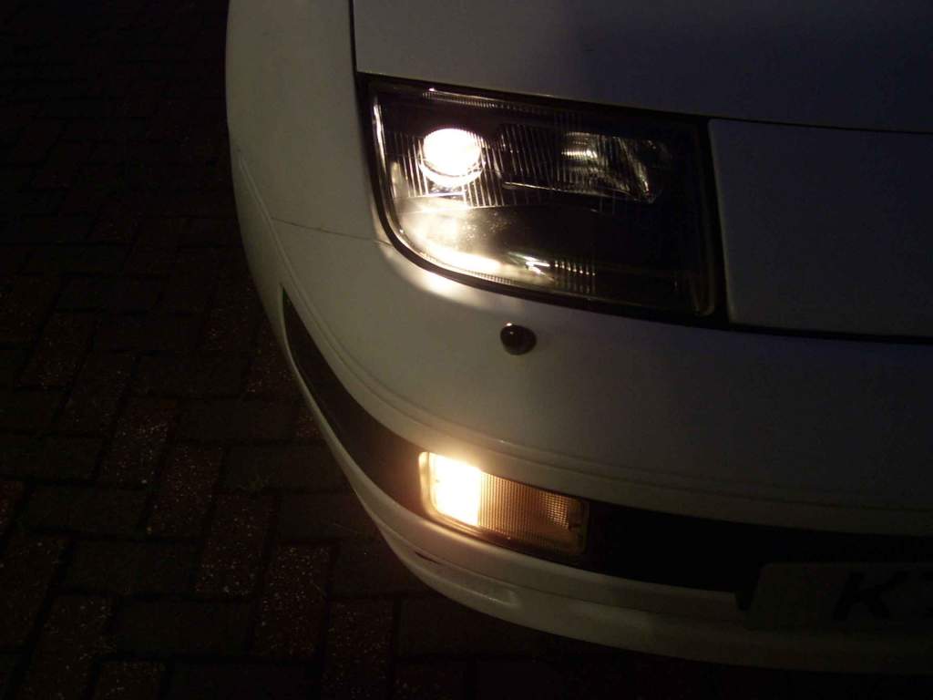

Some photo's of the Dim-Dip and main beam.
Difficult to capture the real difference head on, as my camera could not cope with the main beam brightness.
As for the close ups, the difference was significant.
So chuffed.
Coated the connections in Dielectric grease prior to re fitting, should be good for another 24 years! :lol:

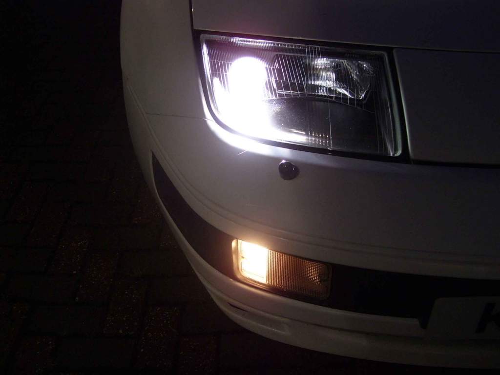

Not only has my electrical repair work restored the function of my Dim-Dip, it has transformed the brightness of my dipped beam immeasurably!
Unbelievably bright, I can now really appreciate my recent head light refurb.
Must have been suffering from poor connections throughout for a while.
Can't help but notice, but since I have sorted my dipped beam, my side lights look very yellow by comparison.
Any suggestions as to how I can bring them up to the same white brightness?
