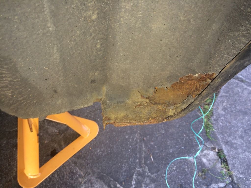

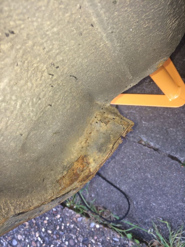

Finally got the z jacked up so could have a proper look underneath, all looks pretty solid apart from what I think is the rear inner sill (if not what do I call this area). I'm sure there's loads of people on here who have tackled something like this before so my questions are:
How bad is it.
How would I go about tackling this, it this a common place that rots and is there a replacement panel I would weld in or would it be a case of making my own panel. Cheers all
Pretty bad when you start cutting away

Hmm was worried that would be the reply I got. Heard about him an if I had the funds and the means to get the car to him I would but it's going to have to be done by me. ughh here we go lol
You can't really know for certain until you start cutting away really.
you would be better off using a grinder it will destroy all the weak rusty metal but at least you'll know when you have solid material you can weld too.
Going to sand the outer sills back tonight if it's all good then I can take the minimum off. I take it the outer sill has to come off to get to the inner sill
Had a flick trough and wow, good job pal I'm praying I'm not going to have to go to that extent I'm hoping it's just the very rear. Has anybody made there own sills ? What's the oem thickness ?
Pattern parts are available through Zcentre. That's the best way to go if you have the dosh, ensures a perfect fit. I made my own pieces but it was a bit of a faff. Matching the stone chip is a nightmare as well.
