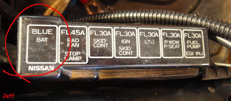

Check fusible links (small fuse box by bulkhead) and the ignition relay in drivers footwell

Before anything else take a couple of minutes to check the main battery fuse, this is located in the slim fuse box under the bonnet on the drivers side next to the brake master cylinder, see the picture, the blue fuse is actually a thermal link and looks like a bad fuse repair, it is not.
Remove the fuse and first check the thermal link for continuity and then look at the fuse holder, these can suffer from corrosion, it then becomes a bad connection and overheat leading to burning / melting of the holder, this then loses connection, to check this correctly may need to undo the fuse holder and look underneath at the cables ( disconnect battery whilst doing this )
