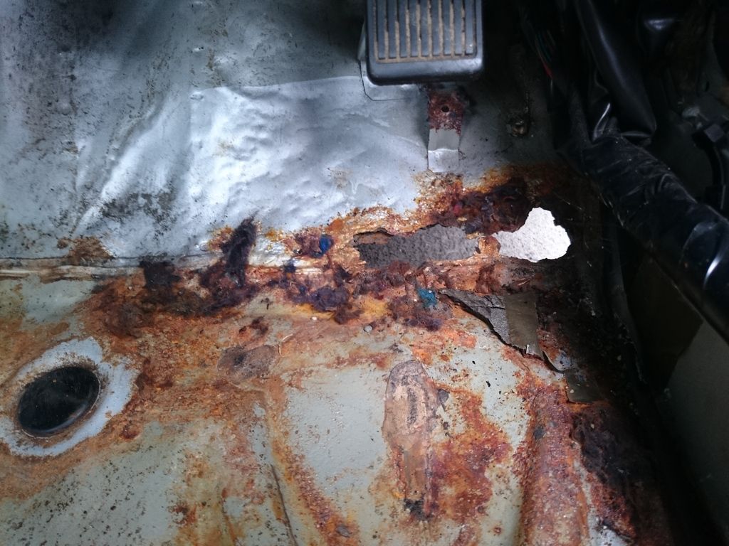

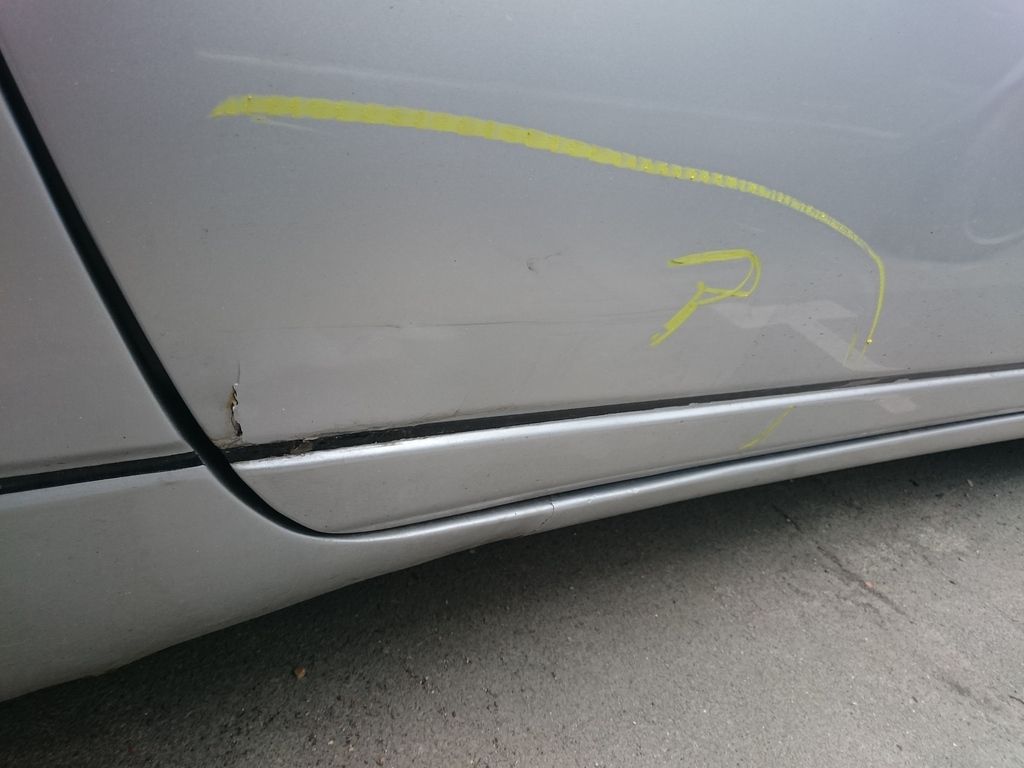

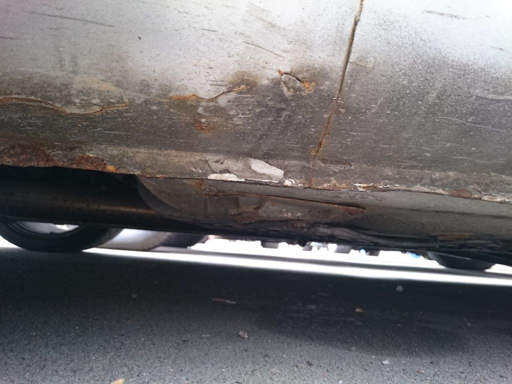

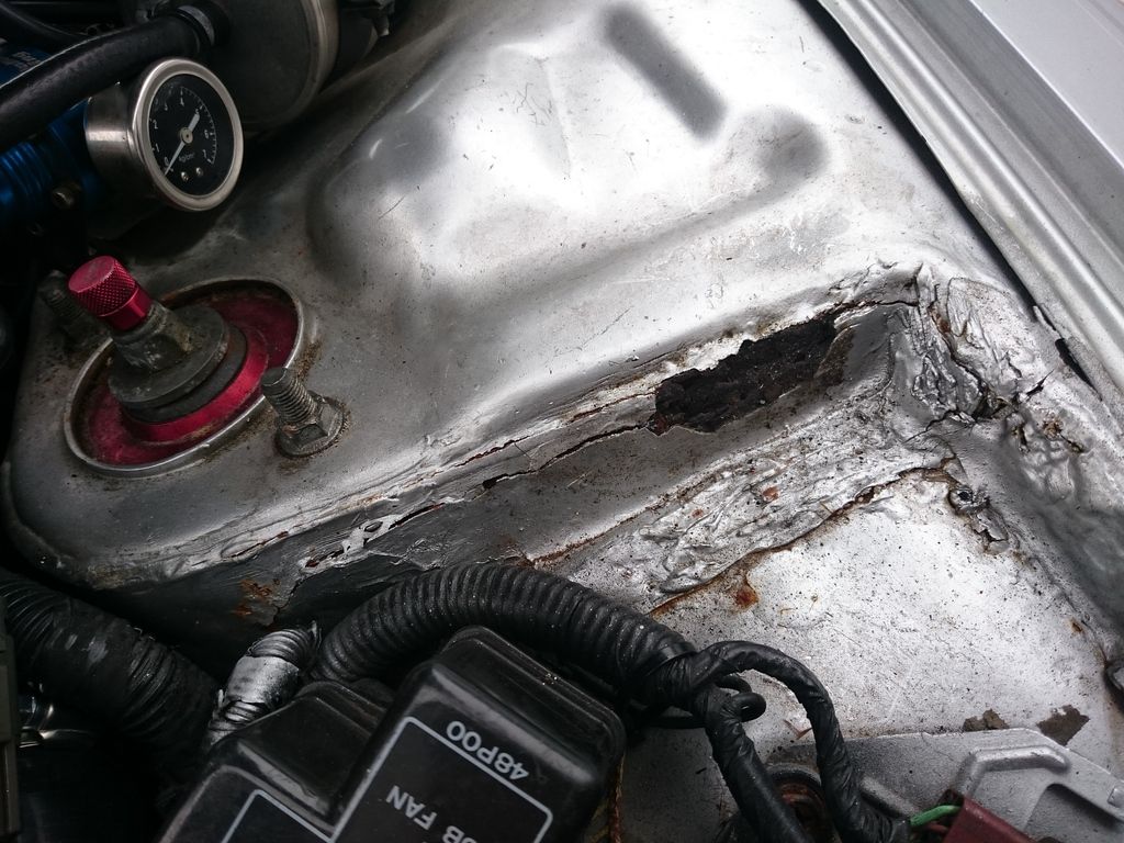

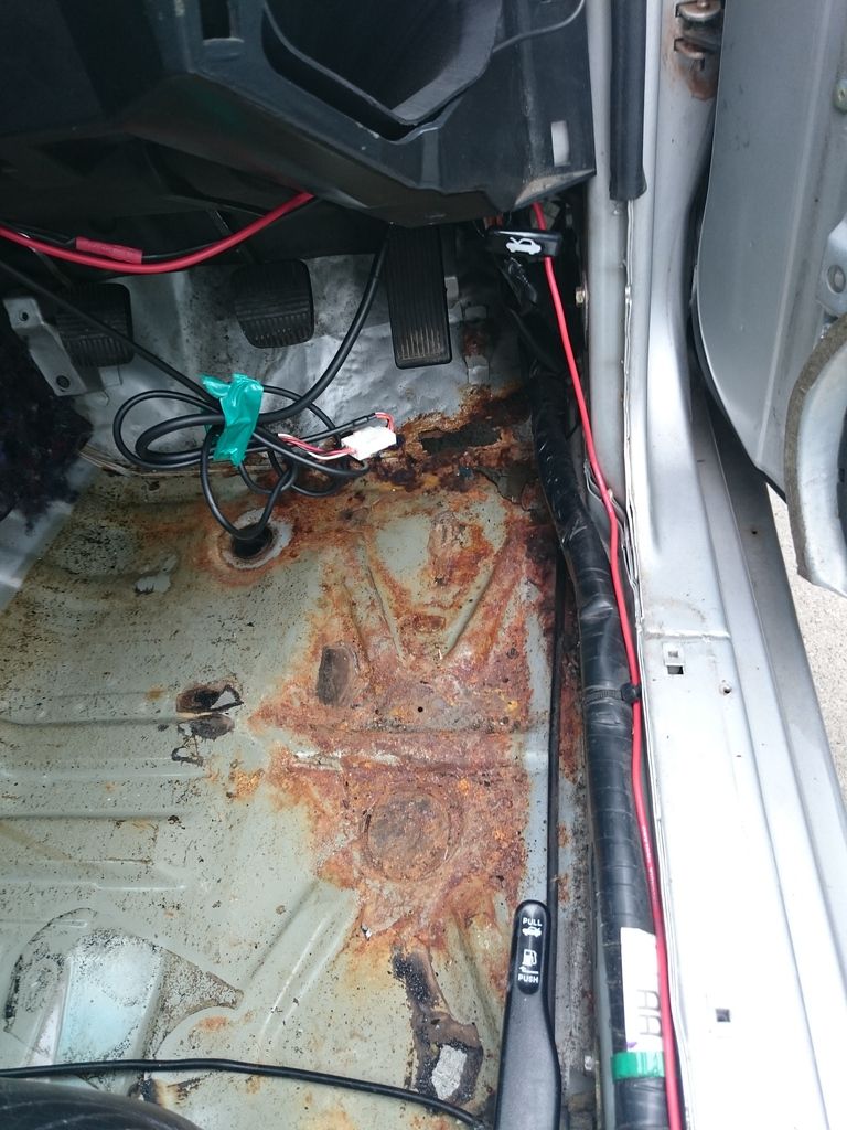

How bad is your current slicktop?
I came back from our bodyshop so annoyed wasn't really thinking, I'm going to buy an na anyway, but I've messaged jimmer and asked him to cancel my slot, I'll source a new bodyshop and rebook with him once it's done. Feel like a idiot, hopefully jimmer can book something else in,
It's ashame bodymech is so far or id take it to them.
I think its the better decision, there isn't much of a Z left underneath that...
Prrrrrrrr that's um, worse than I thought. I mean it's repairable, but there's many many hours in that. It's the kind of project you take on to do yourself because these cars aren't worth enough to pay the panel and labour bill on that. To be totally honest ash unless your prepared to learn to weld and do that yourself then I think that's financially a bad choice. Hopefully someone will take it off you as a long term project.
Re-shell mate. Sorry.
Sills and arches? Behave, a bit of fab and welding at that will be sorted! Certainly less labour that a full engine transplant at a (garage) estimate of 14 hours! Mine is a lot worse that this and I'm not even looking at donor bodies! Keep as many as we can alive guys because it's the donor body mentality that is killing these off! We all knew when we bought these that this is a very real risk and given the Japanese preloaded rust from the factory it's something we have to deal with but why make 2 cars one? Can't understand it, put the graft in and be happy knowing you have!

It's a lot more than his sill and arches. I take it you've got stuck into this kind of this before? What you can see is normally the tip of the iceberg. That's going to be both sills, probably most of the sill. Both rear arches. A rear quarter panel. An inner wing at least, maybe both. A door. Various patch repairs to the floor pan. The panel bill will be racking up quite nicely. That's with no labour. That's a serious undertaking esp for a novice. Months of work fitted around work and home learning as he goes.
Now I dunno about you but I can pull a zed engine in an afternoon. With both cars sat there it's gonna take him a few long days of graft. Like I said, it's save able but it's not finically viable. Your talking about a car that's worth 5k tops, if a shell can be found for sub 1k it's a no brainier. If someone wished to go the expensive route that's great and power to them but if your going to pay for professional restoration your going to need deep pockets.

I can't believe how bad that has got in such a short space of time. When I had the car it had a tiny bit of bubbling on the wheel arches :(
I think when the previous owner had the heater matrix blow, he didn't dry it out properly...
I've never seen a hole like that in a zed before. Was still damp under the sound deadening....

It is a shame, but it happens, will serve me right for not going over it with a fine tooth combe, she's not dead yet, got a call from the fabricator the structural rust is gone, still some cosmetic bits but I'm collecting her tomorrow,
