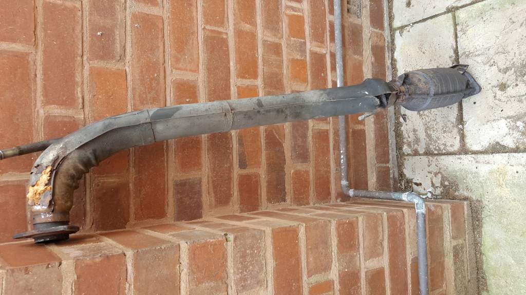

Only UK TT cars had a pre cat on the passenger side downpipe, so if yours is a Jap then no worries :thumbup1:
Cheers guys, it is a j spec, so I'll get it ordered. Do I need gaskets where they mate with the turbo elbows? There weren't any on the cats and I'm fairly sure that's how it left the factory.

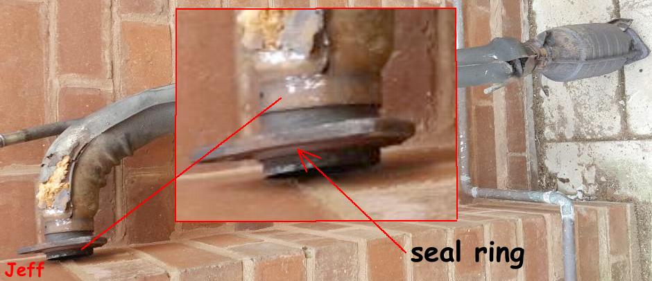

Yes you will need gaskets, the old cats did in fact have seal rings as I have highlighted in your picture, do not use exhaust paste that goes hard like gun gum as the temps are so high it just dry`s out and falls away, use silicon exhaust sealer.
Jeff
[ATTACH=CONFIG]97272[/ATTACH]
Cheers Jeff

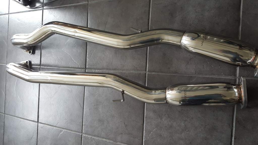

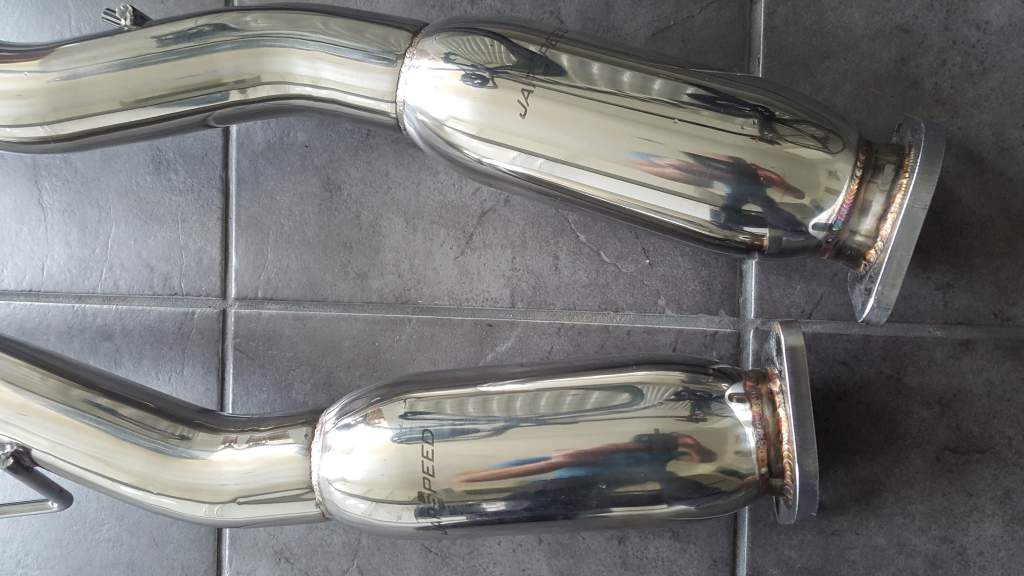

They were delivered 14 hours after I ordered them. They are japspeed decats.
They came with all 4 gaskets and nuts and bolts for where they join the exhaust. The ad states no gaskets or fixings, which is annoying because I've just ordered a set.
To fit the passenger side just required the bracket to be bent slightly. The drivers side needed 'coaxing' with a lump hammer and a block of timber to clear the corner of the transmission tunnel.
They are only slightly louder than the cats, which is ideal, because I didn't want the car any louder.
