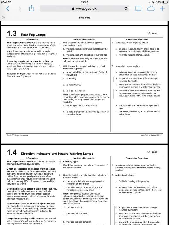

Stephen, I'm a mot tester and I can assure you that there is no requirement in the mot to test the level of any light emitted from any of the cars lights, we do not possess light meters so who can say "it's not bright enough to be a fog light" if your tester is saying this ask him to show you in the mot test a reason for rejection based on how bright your fog light is.... He won't because it isn't there mate.
It upsets me when mot testers simply do not follow the rules and make up there own drivvle on what is and isn't a failure.
I'll attach a pic of the test manual to clarify mate.
Cheers chris. He told me "it should be as bright as a brake light" the suggestion was to use the B light cluster, reading the regs though that wouldn't be acceptable. The LED lamp I fitted was equal to the brightness of a sidelight IMO.

nowhere in the test manual does it state the brightness of any light, he has just said that off his own back mate, this is what annoys me. see the above table in reasons for rejection and find one for fog light not being as bright as a brake light.
