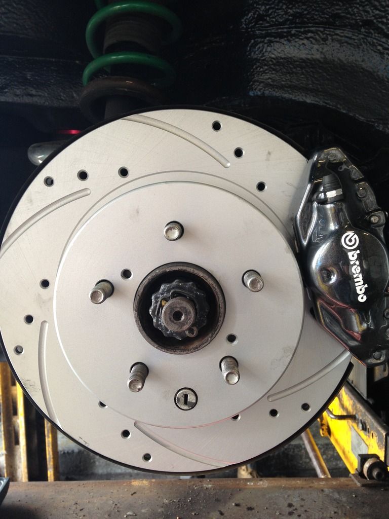

Rears are almost the same as the stock Z32 calipers discs and the fronts are within about 1mm the width of the fronts, diameter is the same as the 350z Brembos. The beautiful is that unlike the 350z rear Brembos, the GTR rear Brembos bolt straight on. It's a great little OEM style upgrade IMO.
Here's the rears on mine, bolted straight on.

It's only the rears that are the same size. The piston in the rear calipers is larger than the stock. It's not essential you do it, but if I'm doing a brake upgrade, I want the calipers to match.
Fronts are much bigger.

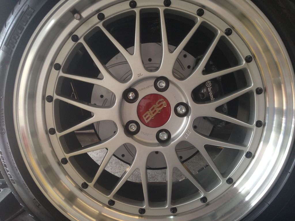

These are the fronts:
Bear in mind that my wheels are 19", they don't look small, they fit quite nicely.

Yes they do it fit nicely, as if they should be there. Compared to the space in the rear wheel, I would like to see something bigger there so they look a little more even, but I'm sure they do the job good :D
