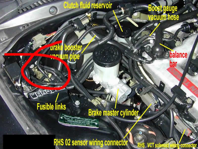

Try disconnecting the AIV solenoids electrical connection (circled in red in pic below ) that way they will not open and should be quiet then, remove later if you wish.
Jeff
