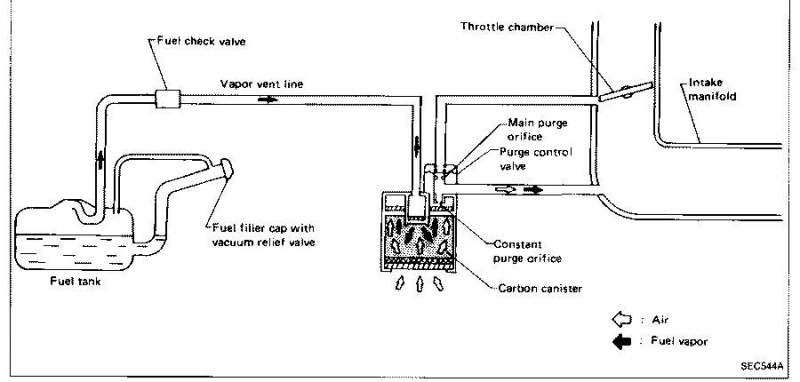

That will be the CC constant purge orifice "leaking" under vacuum conditions (as it should). The evap emission
control system is shown below and shows the basic setup (turbo models have an extra purge line which runs
from the CC to the intake pipe near the air filter.
I've also attached the relevant page from the FSM which describes the CC fuel vapour purging process: efec-190.pdf

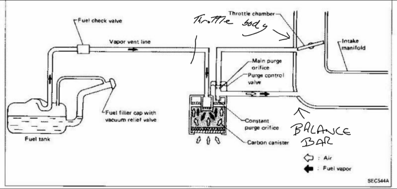

So, looking at this picture, im assuming the other pipe there under the if piping should be connected to the throttle body. On mine, the throttle body nipple is plugged/blocked and the other pipe under under the ic isn't connected to anything. Is that a problem?

So is this about right?
Yes, plus the extra extra purge line which runs from the CC to the intake pipe near the air filter. The n/s throttle connection
runs to the CC purge control valve. If is not connected the CC will not purge properly as the manifold vacuum increases.
"the other pipe under under the ic isn't connected to anything" what does it connect to on the CC? It may be the second
purge line. Connection types are marked on the CC.
