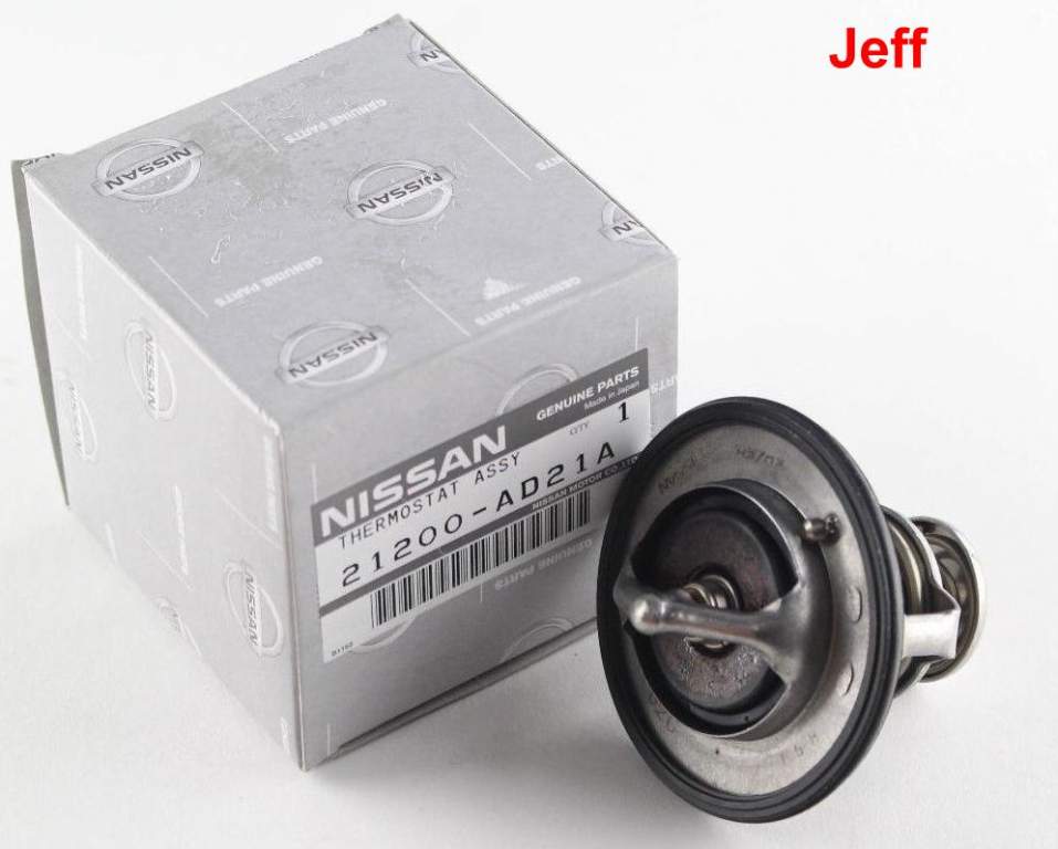

Seems Eurocarparts listing is slightly off but not as simple as you may think, the stat they sold you is for an RB engine as fitted to a 1982 to 1985 Nissan Skyline.
Looking at a genuine RB engine stat you can see how its is looks the same as the one you got from Eurocarparts including the rubber seal, that the Zed one does not use.
However I crossed checked engine types and the RB series and VGD VGDE and VGDTT range do have some part`s crossovers showing and oddly the thermostat is one of them, this I believe is a mistake and it was not Nissan that thought this way and it is just after market listings error which has crept in the system, this happens a lot when spurious or be it non genuine parts are sourced as the manufacturer of non genuine parts rarely have the original spec. sheet and so basically will go through what they know looking for similar fittings and those "similar" aspects can lead to mistakes.
Best to stick with the Nissan fitment, a bad stat can loose you the engine if it goes wrong !!

[ATTACH=CONFIG]96257[/ATTACH]
Jeff, that's an awesome response. I will take it up with Eurocarparts. I did wonder why they had all the correct information, but seemingly wrong stat.
Thanks Jeff, and all. I live and learn! You just don't compromise on quality, I know that. I have always bought either genuine or next best quality. To be honest, I didn't know Nissan did their own thermostat. Thanks again chaps
